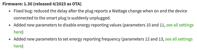

I was informed by Zooz Support, because I had a ticket in, that there is a firmware update for the ZEN04: ver 1.30, vs the current 1.20.
After installing it and using it awhile, these are my observations, such as they are, using the current driver:
-Reporting can almost be totally suppressed, with the exception of energy, (kwh and duration), which still is 1kwh max reporting threshold.
-This suppression can be achieved by making value of the new parameters, 10 and 11, equal to 1.
-Since they are new parameters, this can easily be done from within the current driver, and they won't be affected by save preferences, config, etc.
-On a (side) driver note, I noticed that when voltage reporting frequency was set to, say 1 minute, no reports were generated by the driver despite the fact that the device was kicking them out (as observed in the basic z-wave driver). Only when current reporting was enabled did the voltage reporting start.
-Reporting zero watts, or "off", went from 35 seconds to 5 seconds.
Here is the change log link:
https://www.support.getzooz.com/kb/article/1387-zen04-smart-plug-change-log/
Here is the link to the revised advanced settings page:
https://www.support.getzooz.com/kb/article/1114-zen04-smart-plug-advanced-settings/

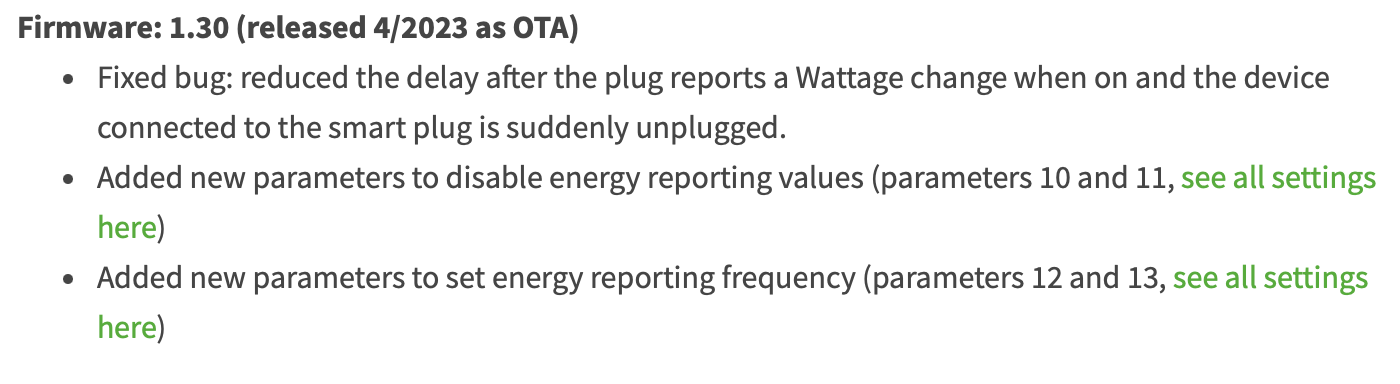

@jtp10181, as mentioned by velvetfoot, firmware 1.30 has been released for the Zen04. Would it be possible to have the new parameters added to the driver?
Thank you for all of your great work on all of the Zooz drivers. All of my three dozen+ zooz devices use your drivers!

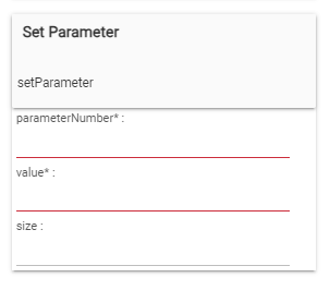

@jtp10181 , would you know off the top of your head what the order of parameters should be in your driver? I used to know...
What do you mean the order? They are in whatever order I have them setup to in the code. I usually go in a similar order as the Zooz docs, which is sort of numerical but also they group similar settings even when not numerical order.
No. I meant param num, size, value
I'm just not sure of that order, and I figured if you knew off the top of your head I wouldn't have to puzzle it out myself.
For the setParameter function? It tells you on the device page. The order shown on the command button top to bottom is the same order to use in RM. I put the size last so it could be optional, if you use a parameter the driver already knows about you don't have to specify the size.
Thanks!
Duh, I was doing a rule and didn't think of looking in the device page.
