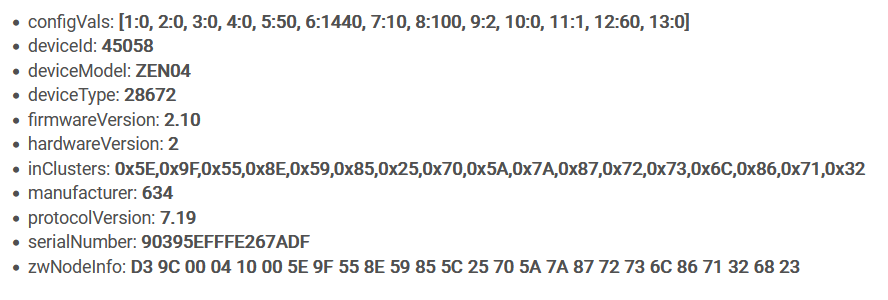

FYI - I just received 2 Zen04s and they are firmware 2.10. I do not know if this is based on 1.10 or if it incorporates the changes made in 1.20 and 1.30 or not. I would assume so, but the changelog doesn't mention hardware V2 at all. I've submitted a ticket with Zooz to find out.
:+1:
Send me the changes if there is anything major.
I suspect you might have gotten 800 series chips with a v2 hardware and the settings will match the prior newest firmware version. Thats what they have been doing recently.
Yup, that is the case. This is the response from Zooz.
The 2.10 firmware on ZEN04 800LR is based on the 1.30 firmware ZEN04 700 series

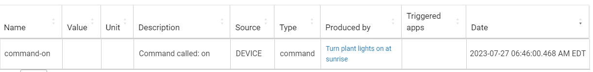

There's something going on with the device in Hubitat... not sure if you need to update the driver for it or if there was something else going on. I got the plug for my wife to plug some plant grow lights into. I created a simple basic rule; turn it on at sunrise and off at sunset. It seems to have turned on at sunrise just fine and I texted my wife and she says the light is still on, but the current state of the plug in Hubitat seems to suggest it's not on.
The events tab shows it turning on and not turning off.

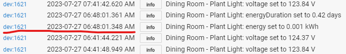

However the log never shows it turning on. It's weird to me it would not show up here. It should have an entry where I drew the red line.

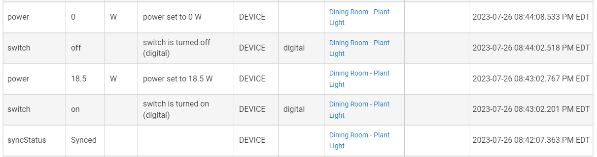

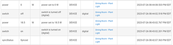

When I first set it up yesterday, it seemed to be working right. Here is me turning it on and off from the device page to test it.
I went to the device page just now and manually clicked the refresh button and the current states updated to what it should be. This generated a "Switch has turned on" event in the logs.

That is actually just showing that the On command was called, the device never responded or there would be a subsequent "switch" event. That is why the switch state stayed as "off".
