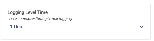

Is there a trick to get this to work?
This is on a Zen04, which is the only thing I've tried it on. It doesn't seem to turn debug logging on for any length of time.
Did you set the settings right next to that to Debug?
You set the log level on one spot and then that is just the timer for Debug/Trace so you dont leave it on forever on accident.
Oh, my interpretation of that was to change the dropdown to debug if you want it set there indefinitely, but set it via the dropdown if you want it to turn off after a bit.
