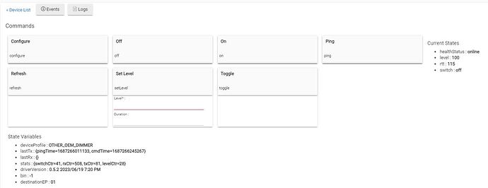

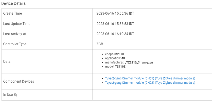

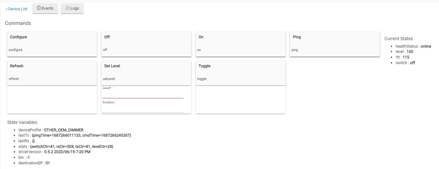

Hi,

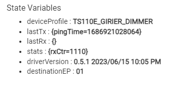

just checked the TS110E_GIRIER_DIMMER
still not working, (Cant see any difference from last time) (Except for the fact that both boys are created)
problems are:
Mechanical switch not responding.
Every change in intensity through the dashboard, the lamp reaches the desired level and then lowers intensity until it is turned off,
(for both channels)

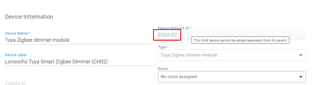

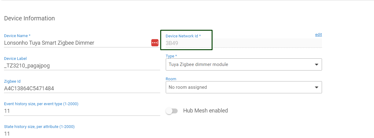

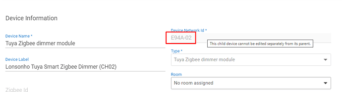

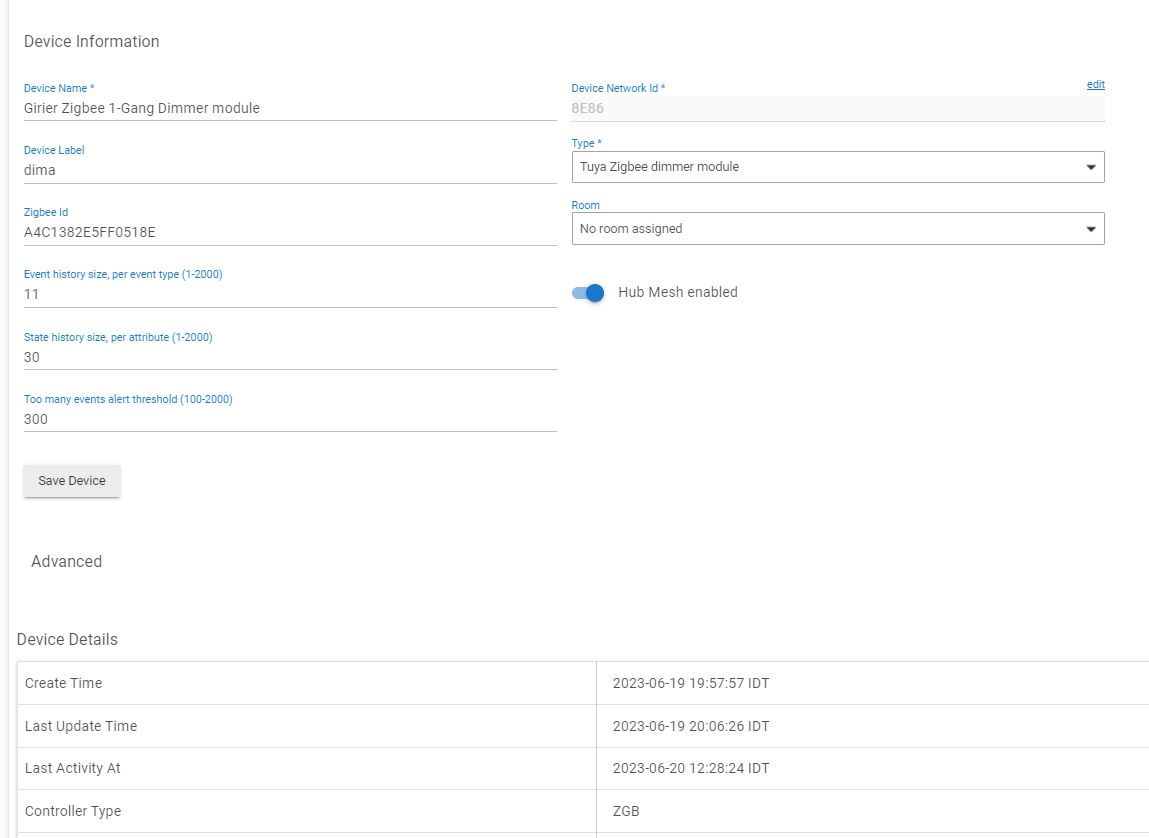

Thank you for the detailed logs! I see now why the mechanical switch turned on was not reflected in the driver, but why the level automatically goes down to almost zero is still a mystery.
@user5386
Can you compare the Device Network Id* of the 'father' device v.s. one of the child devices?
The screenshots below are from another dimmer, but it illustrates the weird scenario when the DNI of the device has been changed by HE (probably after pairing the device again) and now the 4-digit DNI of the father and the child are different - this breaks this driver logic... : (
Father DNI :
Child DNI:
Im away from home. I'll do it this weekend!
Thanks!!

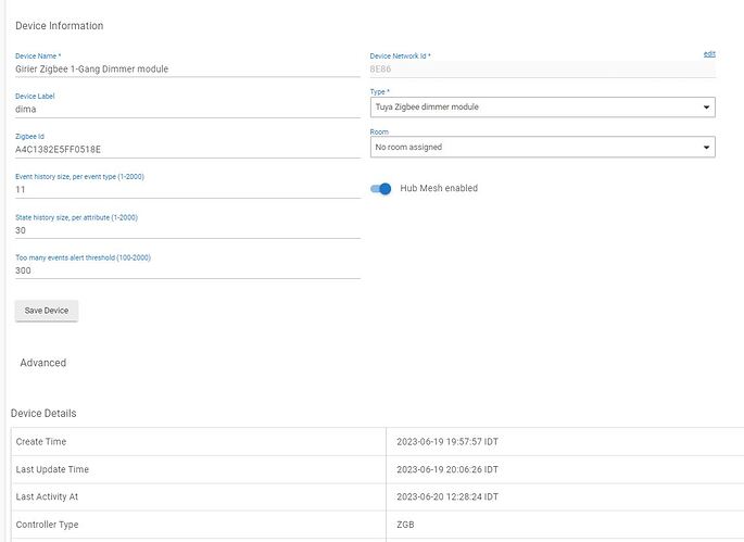

Hi,
two comments below:
first one, dimmer 1 way GIRIER
in fact it's act good except the physical switch issue, (witch not responding).
(also works great with google home)

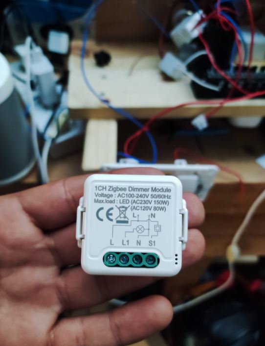

Last night I damaged one Lonsonho 2-gang dimmer by wiring the external switch the wrong way.. : ( I must slow down and fix the issues one by one.

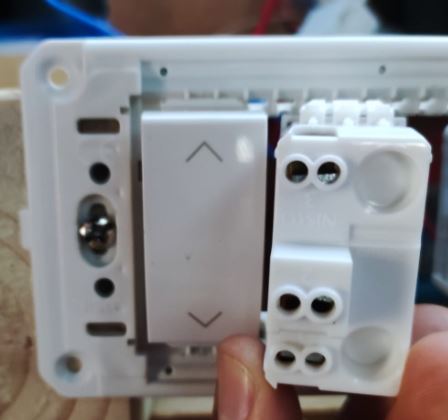

Is this an on/off switch or a momentary switch (contact is closed only until keep pushing the switch down)?
Its a stupid ON/OFF switch..
This explains the behaviour… what we need is to configure your dimmer in ‘external switch on/off mode’. Most probably the default mode is ‘momentarily’.
… but you’d better check in your local store whether there are momentary switches from the same series / design / color.
A momentary switch operates this way:
  • short press - switches on/off
  • long press - ramps up/down the dimmer.
humm...
my switches are:
qq1
i guess this what i understood from the wiring on the module:
i thought momentary switches are:
qq2
i will search for a "NISKO" such a switch.
But that brings me to my even bigger concern now.
I ordered this extremely expensive module (for the large shutter at the exit from the living room to the balcony) and now I'm a little afraid that it won't work with the momentary switch I have?
Probably like this one?
thanks!!!
