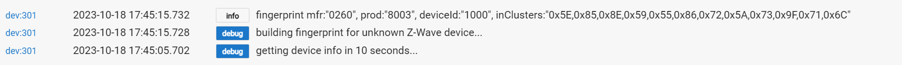

Hi,
the only log I get is this:

Ok sorry can you try/do one more thing. Install and switch to this driver: [RELEASE] Z-Wave Universal Device Scanner
Set the logging to debug logging.
Sounds like it sends a notification when you plug it in, so unplug and the re-plug it. Should get some debug logs from the alert.

Hi,
this is what I got from logging:
Hmm, it seems it just keeps reporting gas is detected but never reports in that it is clear.
The manual says when you plug it in you need to let it warm up (I assume so it can calibrate). The LED will be flashing. It says NOT to try to test it while this is happening. I would be curious to see if it eventually sends a cleared notification after it warms up and LED is solid green. Would need debug logging on to see the message. It should be another NotificationReport, type 18 still but event would be 0.
