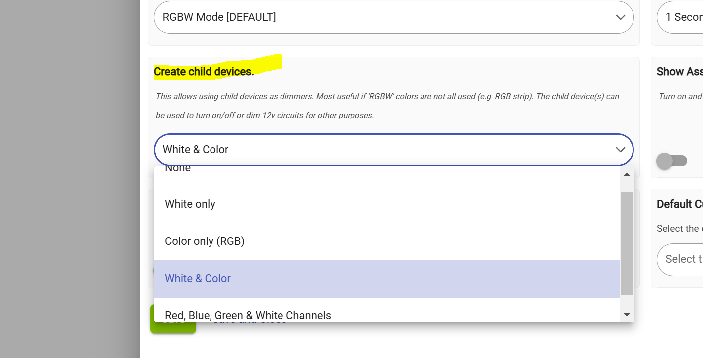

Most importantly, it allows you to choose how child devices are created or you can select 'None' for no child device:
Each child device is created as a dimmer, you can only set the color on the main device.

Screenshots would help. All that's needed is to hit the configure button and it will created appropriate child based on what you selected in "Create child devices". I often use "None" if all I want is RGBW control of one LED. You can choose "None" as a way to remove all child devices.
In this case, I would choose "None" and use a single/main device.
