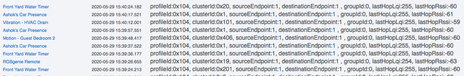

My door does not show up in that list, but my 6 lights and 1 plugin does.
under the live log, is the "-number" the signal strength? higher is worse signal and lower is better?
Never mind I found that info.
Here is the door. Front Door2020-05-29 13:56:42.608 profileId:0x104, clusterId:0x101, sourceEndpoint:2, destinationEndpoint:1 , groupId:0, lastHopLqi:238, lastHopRssi:-84
here is the outside light that has failed to turn off. Outside 12020-05-29 13:57:21.768 profileId:0x104, clusterId:0x6, sourceEndpoint:1, destinationEndpoint:1 , groupId:0, lastHopLqi:240, lastHopRssi:-77
here is a light 10 feet from the hub. Basement computer2020-05-29 13:57:48.406 profileId:0x104, clusterId:0x8, sourceEndpoint:3, destinationEndpoint:1 , groupId:0, lastHopLqi:255, lastHopRssi:-58
and my other outside light is going through one of the GE basement lights.
status:Active, age:64, routeRecordState:0, concentratorType:None, [Outside 1, 8F89] via [Basement toys, 8116]
Some devices don't show in the Child and Routes, so that is normal.
None of those look completely unusable far as signal strength, or at the very least, I have seen worse. You can see the front door and outside is weaker than basement computer. The Front Door could definitely be better though, and something to try to improve. Most everything in my house is at or near 255 LQI, and closer to -60 average for RSSI. My worst are -73 and best are -48 for RSSI, and my worst LQI is 248.
