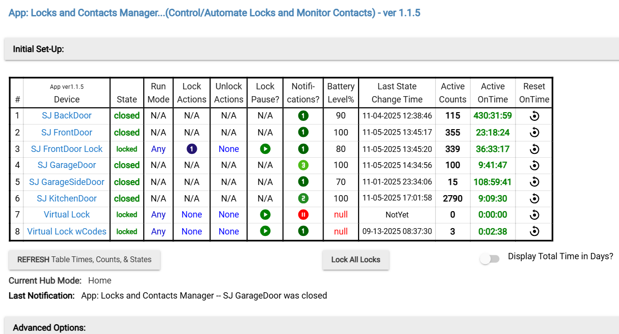

This app is a little fresher and focuses on door contacts and locks. Has 3 push notification menu options also. It counts how many opens but I can add another option today that will count; only closed or only open, or both. Also was planning to add a "reset all counts" at certain time weekly option.
Making this app to replace a couple rules and some outdated apps. Control locks and monitor contacts.
[image]
Features:
--Manually control locks and view contacts status from app.
--View last active time stats and counts
--Use Contact sensor to Auto Lock locks after a delay Option. Cancelable and Retry
--Auto Lock a lock if left unlocked Option
--Auto Lock all Locks at a certain time of day Option.
--Auto Lock retry after 5sec if failed Option.
--Get push notifications of locks and conβ¦

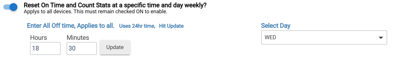

@basic261 , OK, added some things that might meet what your looking for:
New version 1.1.7 adds the following:
--More count options: open/unlocked, or closed/locked, or both events.
--Reset all Devices Active On time and Counts at a specific time daily or once a week. Option to send a push notification of all the stats at time of reset.
[image]
[image]

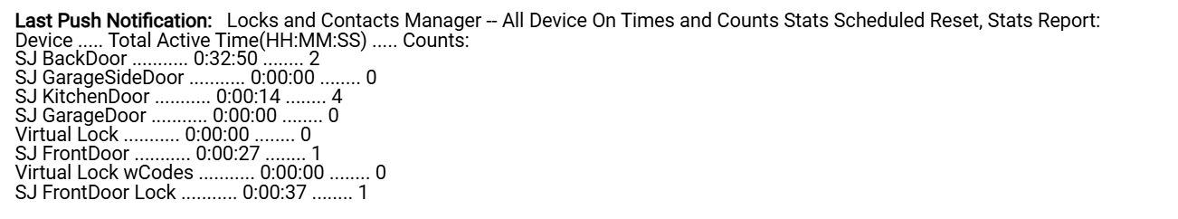

Push notification of Device stats at specified Reset time option will look something like this but the formatting will look different (worse) on your phone
