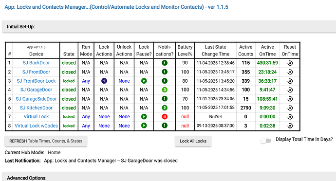

--Manually control locks and view contacts status from app.
--View last active time stats and counts
--Use Contact sensor to Auto Lock locks after a delay Option. Cancelable and Retry

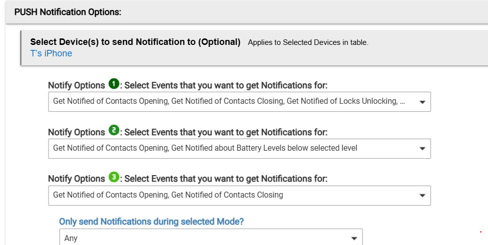

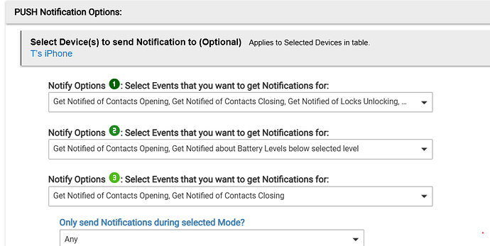

--Get push notifications of locks and contacts actions, per device, 3 Options.
--Monitor Lock and Contact Battery levels. Get low level notifications if selected.

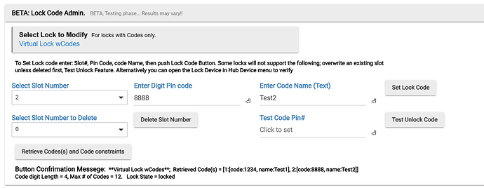

--Lock codes; set, delete, or retrieve codes. Ver1.1.0 and up. This part is BETA, I only have 1 lock type to test.
--Count open/unlocked, or closed/locked, or both events.
--Reset Active On time and Counts at a specific time daily or once a week. Option to send a push notification of all the stats at time of reset.

Ver 1.0.3, Added ability to select specific devices to get notifications from, if not all.

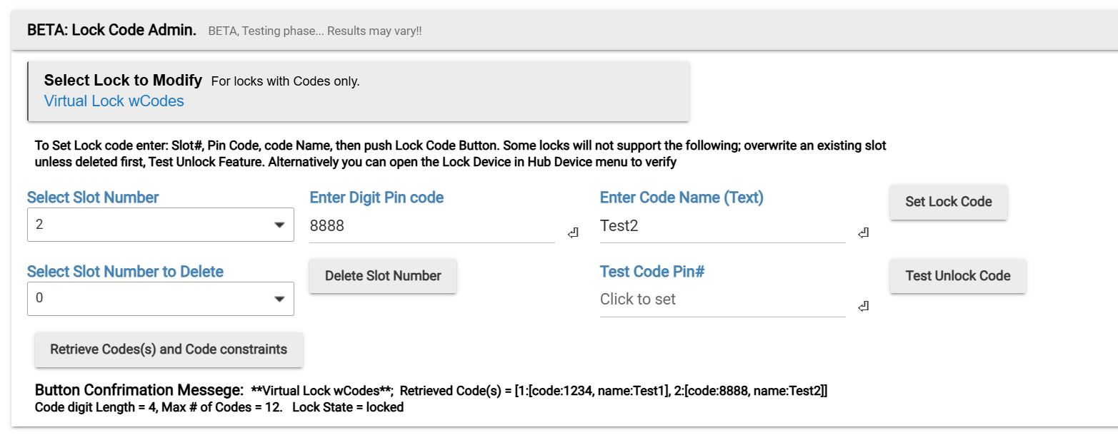

New section in app. Lock Code Admin BETA. Not sure if this will work for all locks as I have only one real lock and a virtual lock to test with. Starting with App ver1.1.0
Features:
--Set Lock Codes
--Delete Codes
--Retrieve Codes
One weird thing that I haven't solved is that the Buttons are very finicky. Like they don't always work. I found that the bottom left corner of the button works best. Need to sort this out still. If the Confirmation message changes then the button worked.

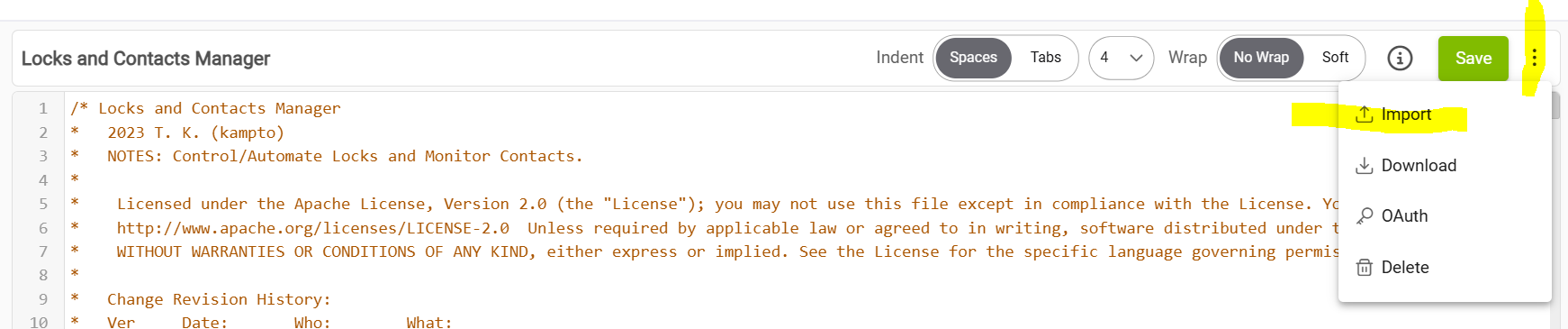

If you already have the app you can easily update by going to Developers / Apps Code and opening the App's previous install, then Import. Save App.
Added a 3rd notifications option so more flexibility on what devices get what notifications. ver1.1.5, on github
