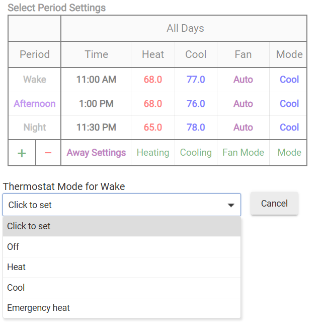

Does the thermostat scheduler handle auto mode?
I have a Honeywell T6 configured and running on a schedule. Does the Hubitat thermostat handle auto mode to switch between heating and cooling?

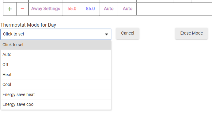

My T6 using the generic z-wave plus thermostat driver does.

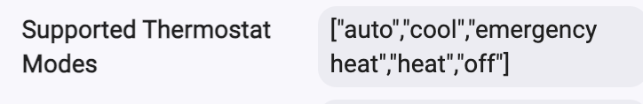

On the device page, ensure that Auto is listed as a supported mode.
If the thermostat doesn't list Auto as an option, it won't show in the dropdown in scheduler.

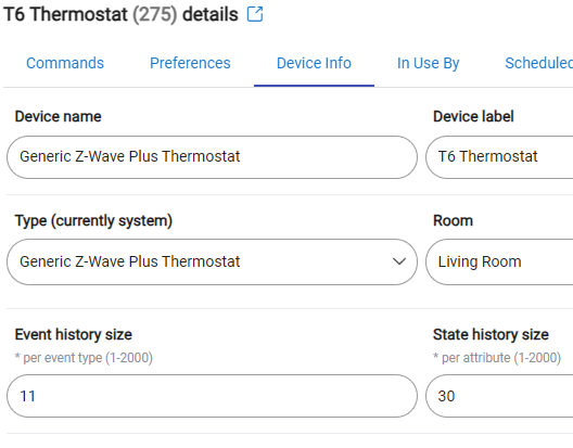

Is this the driver:
In the image the drive name is listed in the field labeled "Type"
The drop down in that field allows you to pick a different one from the list.
Thank you! I'll try changing the driver (Type) tomorrow to Generic Z-Wave Plus Thermostat.

Thanks. I went with the generic driver which give me the auto mode.
