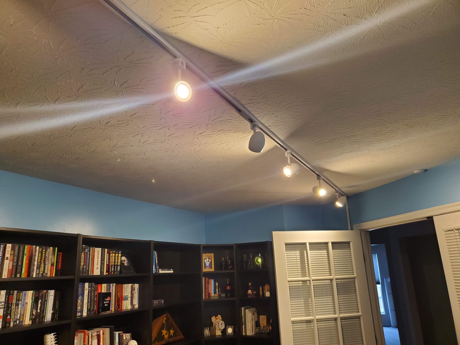

We have added a dimmable track lighting that uses 6 dimmable GU10 leds (4.5w) bulbs, that has a 3 prong plug. I was looking to use a Smart Plug-In Dimmer to control them. But I could only find smart plug-in dimmer that only accepted two prong plugs.

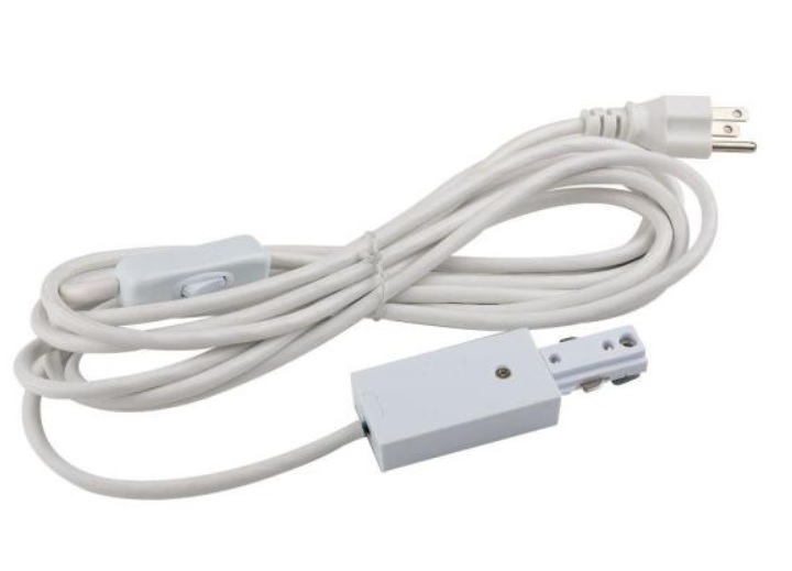

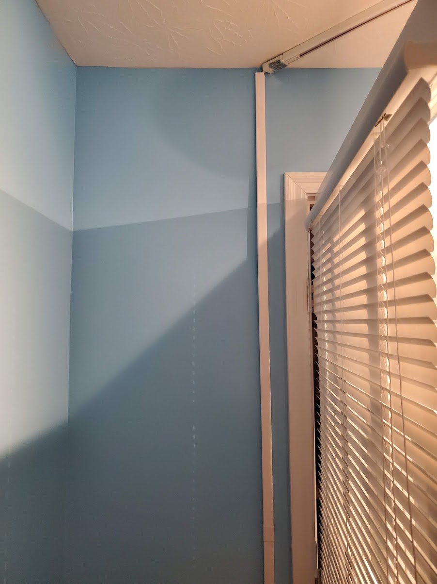

This is what we have....
https://www.homedepot.com/p/Maximus-5-ft-White-Track-Light-Power-Cord-M-TLA-PC-WHT-5ft/206989277
And the end plugs directly into the track light without any transformer down stream? If the track is 100% AC powered and not DC (transformer) then they should be dimmable. If you already have a two prong ZigBee/Zwave Dimmer available, you can quickly test using a 3 to 2 prong adapter. If it works, then purchase the aforementioned 3 prong plug in dimmer.

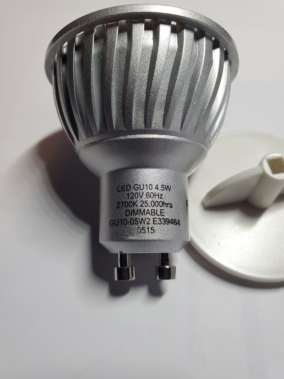

Edit : Just realized that you're using LED vs Halogen GU10s. Halogens are very dimmable throughout their range, LED GU10s may either not be dimmable or have a restricted amount of dimmability range. You should test everything before you install!!!
The Gu10 LEDs are dimmable.....

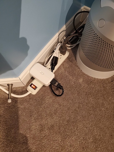

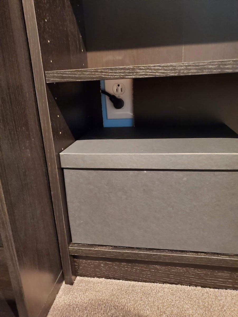

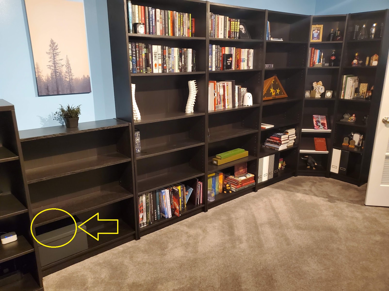

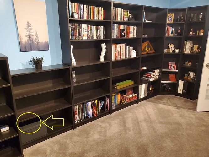

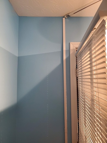

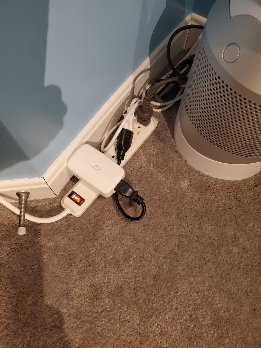

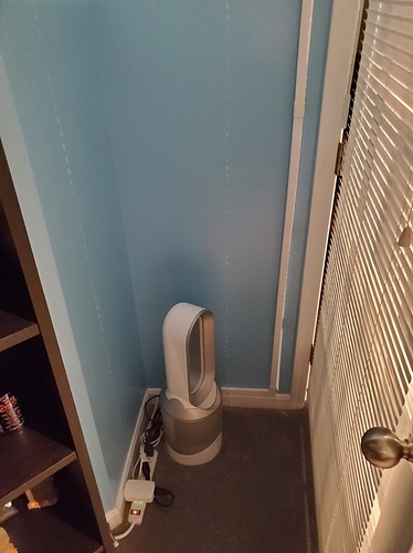

What I have done last night was take a 8 inch extension, 3 prong plug and broke off the ground prong and plugged that into the 2 prong Zigbee plug-in dimmer. I was able do dim all the GU10 LEDs just fine.

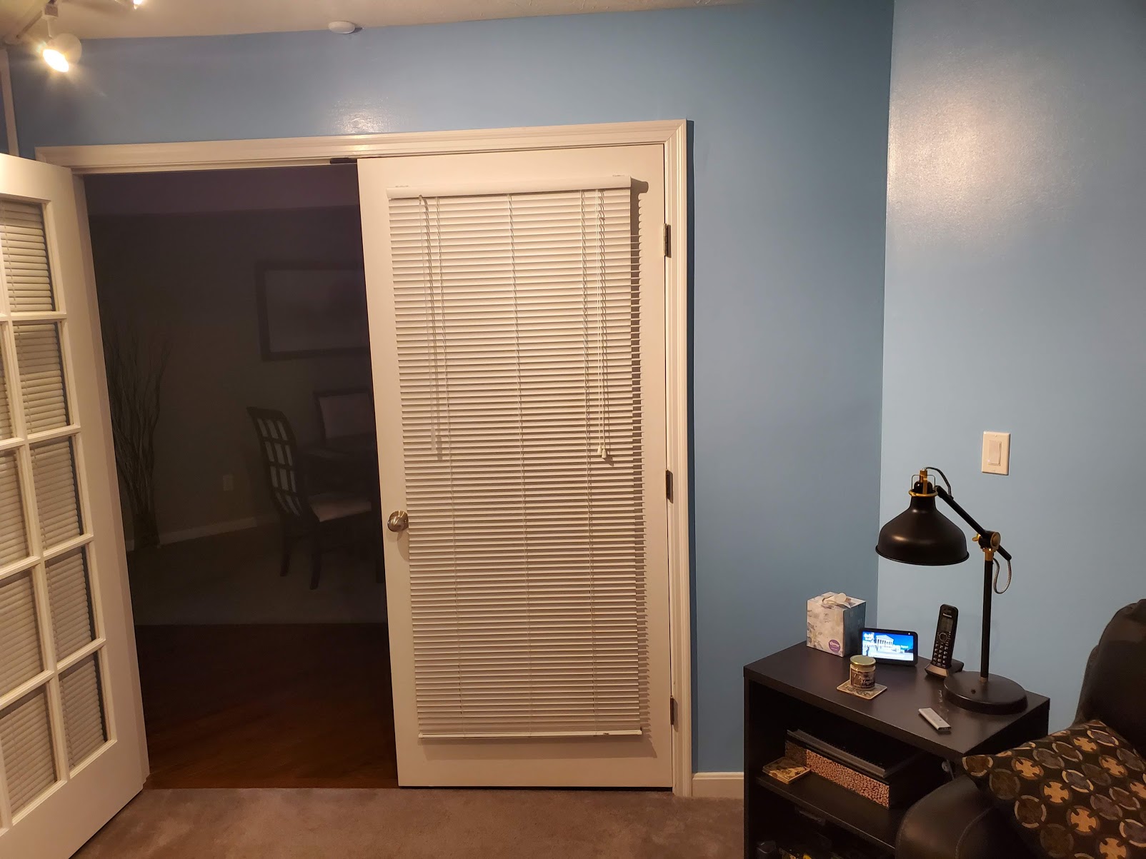

The only switch in that room, controls an outlet on the other side of that room.

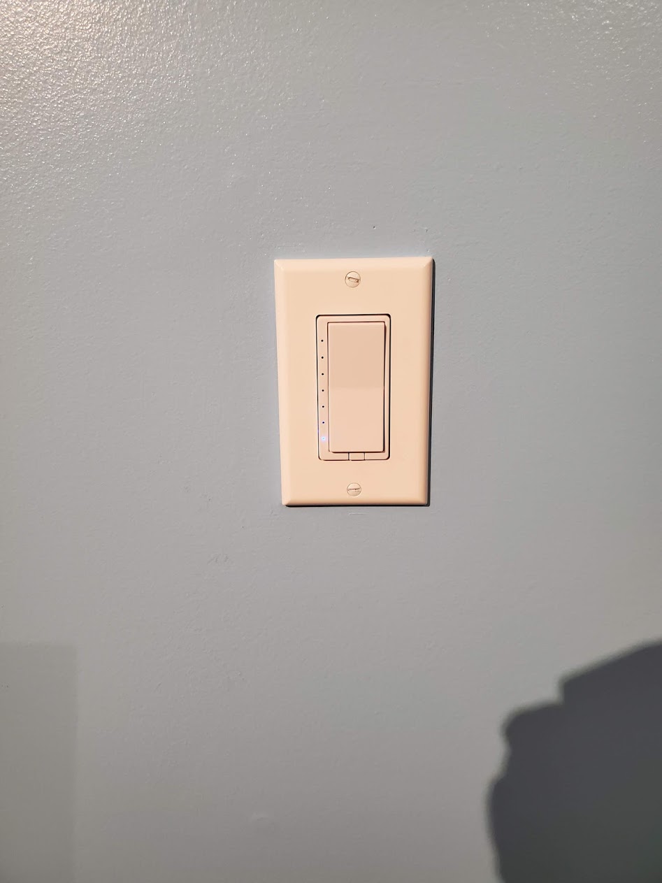

So what we already did before was install a Homeseer dimmer HS-WD200+ (because of the notification LEDs) as a replacement for that outlet switch. The Homeseer dimmer is not physically connected to any lights, just to that outlet that we do not use.
We added a smart plug-in switch to the track lighting in order to just only turn On and Off the lights, using the Hubitat's Mirror App (Homeseer dimmer --> Track smart switch).
We have the Nyce ceiling motion sensor that really turns the track light on for us 99% of the time. We rarely use the Homeseer dimmer but to pause the motion sensor from turning off the lights if we need to.
We have always just had the track lighting just simply turn on or just off.
But last night I decided to add a smart plug-in dimmer, just to be able to have the ability to dim the lights every now and then if I wanted to.

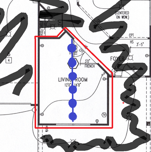

And for those who might say, "Why didn't you mount the track lighting in the center of the room?"
We actually did, that room is not squared. The blue line and circles represent the Track lights.

Since the dimmer is not double-insulated, you should not remove the ground prong. If something happens (fire, injury) and your insurance company finds out (which they will) they will reject your claim.
