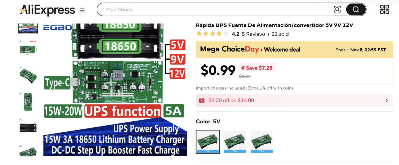

Ouch, those are high priced dodads. I liked my out of pocket cost better. ~$10.00 for three units, now that I also know the voltage can be changed by removing a resistor from one option to another. I can show where in a pic if you need one.

I just went back and checked and the one the OP was showing only holds one cell so at best, 3500mah? This one uses two cells. There seems to be a lot more components on this one than the 1 cell unit. Also, I do not know the possible runtime tests (per device), but I'm running them now. The Motorola mesh routers I am using actually needs a lot of power to boot it up and I have 5 of them scattered around my property.

Search form “Type-C 15W 3A Fast Charge UPS“
[Ask me how I know it works.]
Yep, that is the one. Just make sure that when looking at the component side, with the usb-c on the left side, on the upper right side, you will see a place for 12v, 9v, or 5v for the led. Only one place will have the led but the other two are there so if you change the r7-r9 values for requested voltage out, you can move the led for the proper voltage after replacing r7 & r9.
