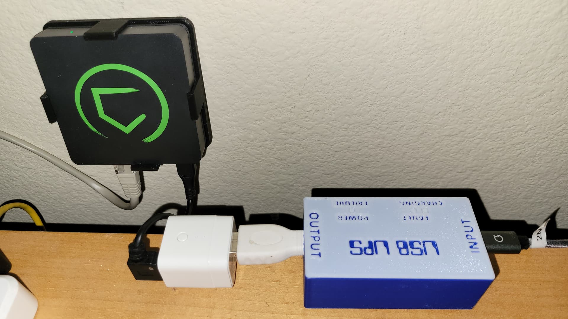

But the good one is up and running!
Excuse the clunky connections, I have a complicated setup due to Wi-Fi plug between UPS and hub, to manage shutdown\restart of the hub if I need to.
