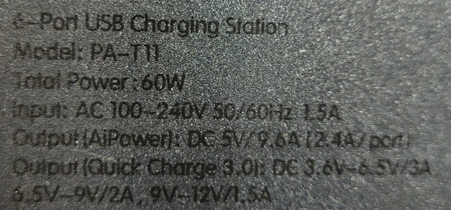

I found a few of my old travel chargers that light up the Charge LED when connected to the UPS. I'm using this to charge both of them right now - that seem reasonable? I'm using the two Quick Charge ports on it, as they had the highest output readings.

2.4A per port @ 5v is good (12 watt). :+1:

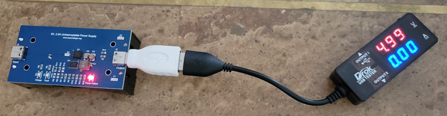

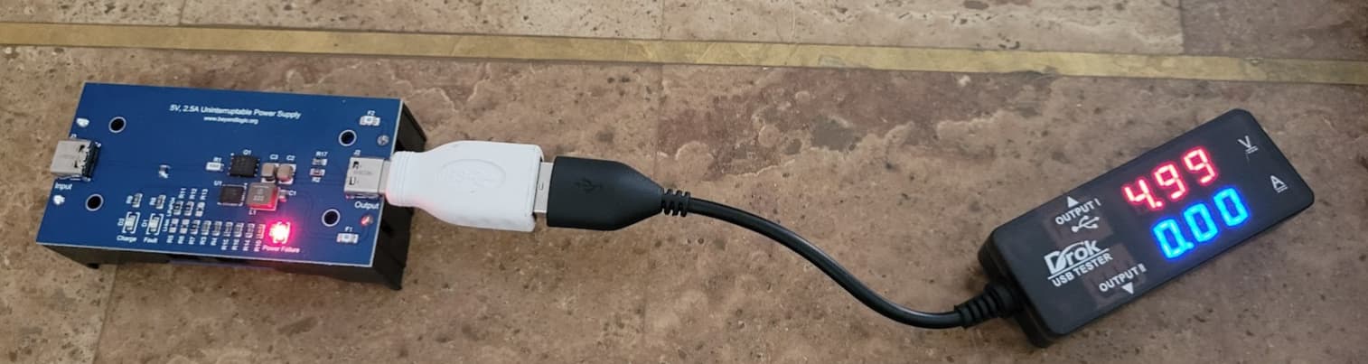

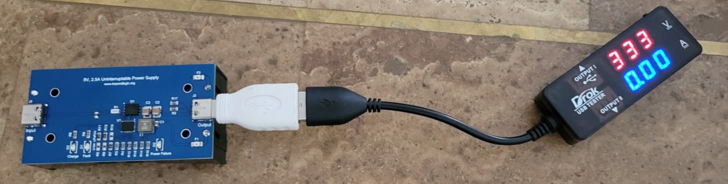

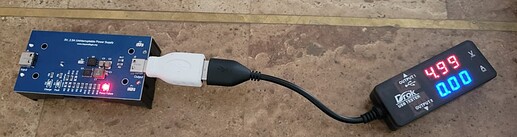

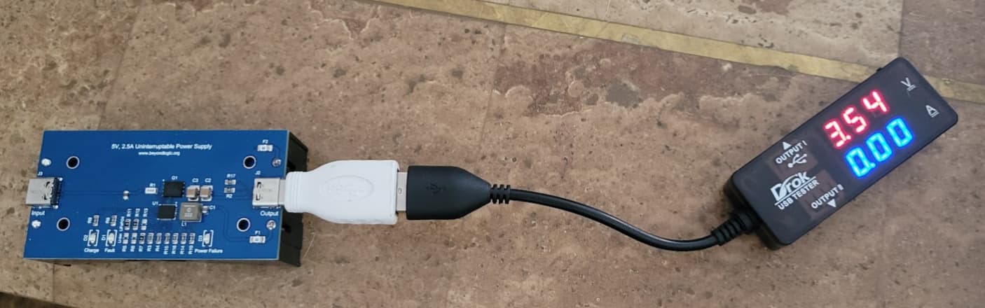

But...unfortunately one unit doesn't seem to like me very much. haven't had time to do a bunch of testing, but:
  • When I came out this AM, unit 1 charging ligth was out, as expected after charging all night. Unit 2 was still reporting charging.
  • When I unplugged both of the units, unit 1 showed power loss LED, unit 2 didn't show any change.
  • I swapped batteries between the units and unit 1 continued to behave normally (batteries showed fully charged, power failure LED on when unplugged) and unit 2 behaved as before, showing charging when plugged in and no power failure light when unplugged.
I checked power output on the two units on a simple meter I have, and then switched batteries and didn't find any difference resulting from battery swap, unit 2 consistently showed the lower output, and the power failure light isn't coming on.
First output check:
Unit 1:
Unit 2:
Second output check after swapping batteries between units:
Unit 1:
Unit 2:
One question in general is whether the output level on unit 1 is as expected? Just want to confirm what "normal" is.
Anything I could have done to cause the issues w/unit 2? I know you tested these before shipping. had to bend out the battery tabs to make them have good contact w/my batteries, so while I was bending and testing the fit I could easily have put one or more of the batteries in the wrong way. Could that have caused behavior like this? Let me know what you'd like me to try/report. :slight_smile:

That is odd - at the most basic level, it should show a power failure as soon as batteries with more than 20% charge are installed. Are your batteries "button tops" or "flat tops"?
I'm wondering if the holder isn't making good contact with the batteries. I used button tops that really push out the spring terminals. It may be worth trying to extend them away from the case so they apply more pressure to the battery terminals.
~5v output is expected - 4.99v is withing spec.
Putting the batteries in the wrong way won't hurt anything - I've tested this several times (intentionally, of course :wink: )
