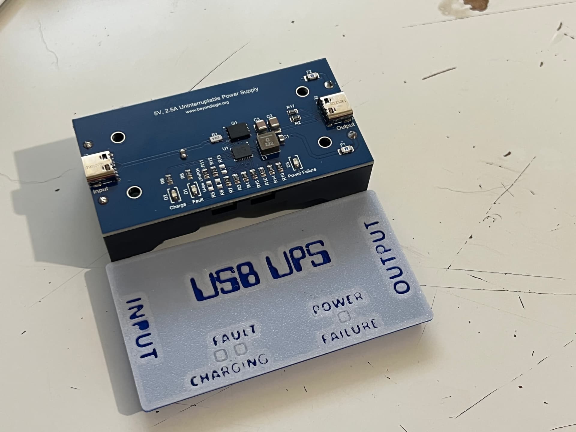

You need to incorporate this into your PBC design, :laughing:
Yes, it can supply 12 watts on 5v from the USB A port.

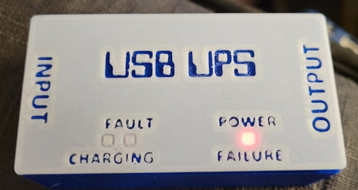

A question (of course) - I put batteries in them and one is reporting a fault, while the other isn't reporting anything. Which one of them is right? :wink:
Anything I need to do to clear the light?
I don't appear to have a suitable charger in the house, tried a few that I thought might work but didn't get any response from the UPS (charging light didn't come on) so not sure if that would do it.

Hmm, try switching the batteries - you might have a dud battery. I assume you installed the batteries in parallel?
Btw, did you match the Input with the lid? Power can only go in one side - It wont damage it, but it'll prolly show a fault.
A power supply. :sunglasses:
if the batteries are already at 80%, the charging light wont come on - try plugging something into the output and see if it powers it.

That didn't change anything - one unit is no lights, second is still power failure light on. Made sure that the batteries are in parallel, moved them back and forth between units and things stayed the same.
I plugged my phone (Galaxy S21) into them:
  1. Unit w/Power Failure - a warning appears on the phone that the device can't charge the phone
  2. Unit w/no lights - nothing happens on the phone, no charging, no warning
I'll dig up or purchase a charger that works w/these so I can ensure they have a full charge and go from there. :slight_smile:

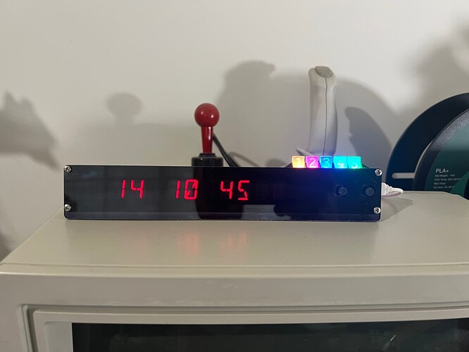

I tested all the units with unprotected, 1600mAh LFP / LifeP04 18650's, and they all charged batteries and all powered my WOPR Clock with power removed.
I do wonder if some of the batteries you guy's found in Murica are a little on the cheap side?
Under $10 USD for some of them seems a little too good - The batteries I bought were $22 AUD / $15 USD each.
