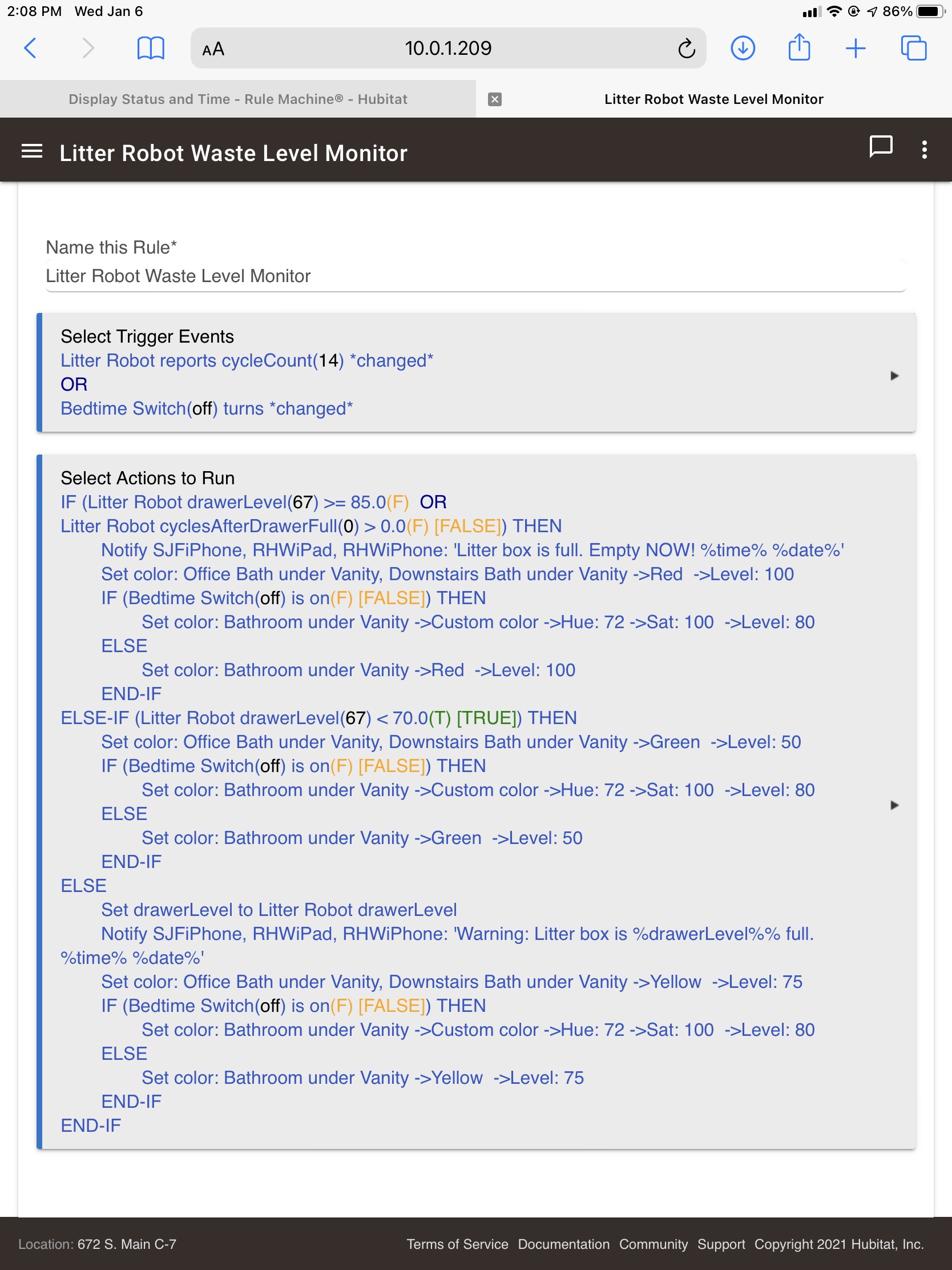

Simply FYI, here is my rule that changes all the vanity under counter lights according to Jared Zimmerman’s (@jared.zimmerman’s) inspiration (his original way was to use IFTTT).
Litter Robot Litter Level Monitor
Bedtime Switch is a virtual switch that Alexa can change, and that also turns on at 7:30 and turns off at Sunrise. My wife doesn’t want to be bothered by litter level information in the Master Bath during bedtime.
