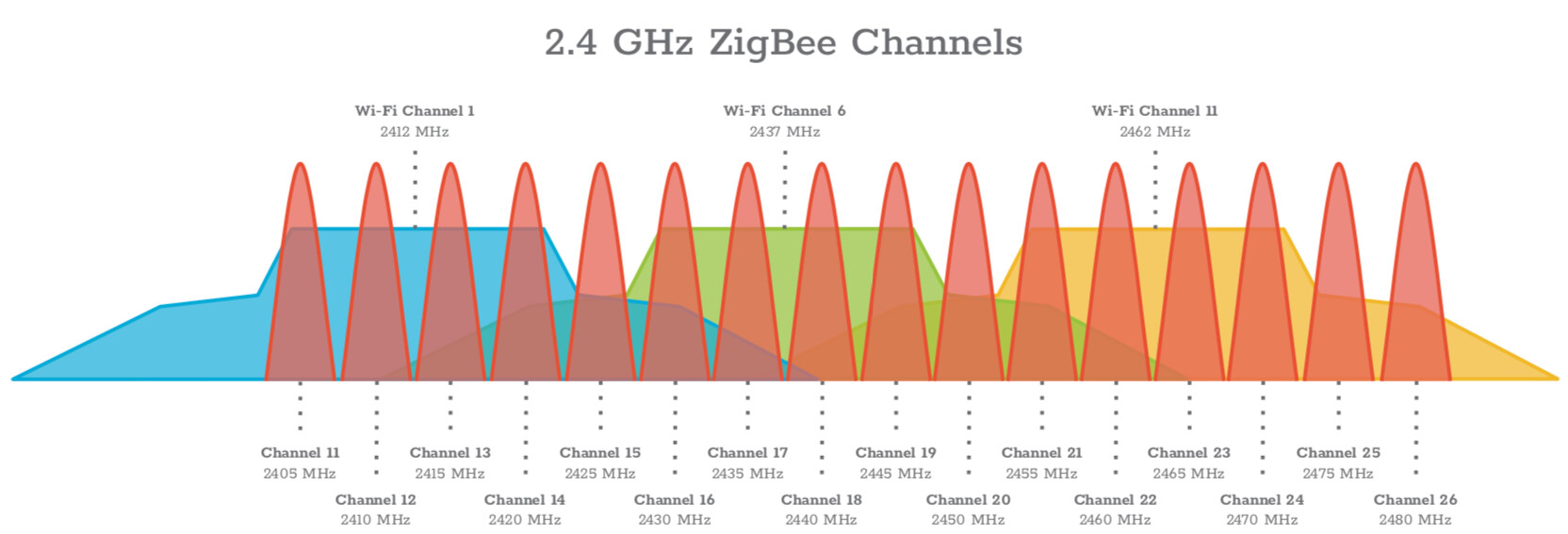

Really the best way to decide what channel to use is to download a wifi analyzer. After you know what wifi bands you and your neighbors are using make your decision. Also most routers have channel selection options but are usually set to auto. Be sure to set yours to a fixed channel. You can't really do much about the neighbors unless you are friendly with them and offer to help them out by fixing their wifi and set a fixed channel, but you can at least be aware of what they are using. Hopefully the signal noise is relatively low.
This is a popular image used to depict where the wifi and zigbee channels overlap.
Zigbee channel 11 is square in the firing line of Wi-Fi Channel 1 btw. Channel 15 or Channel 20 would be better options. At least you would get a better signal to noise ratio.
