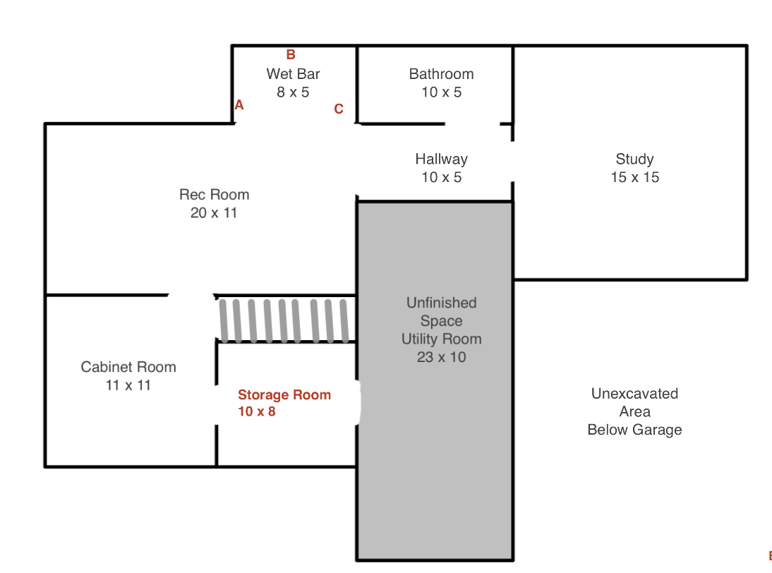

I have a "wine bar" area that is part of a larger room. The area is marked Wet Bar in the attached graphic. Can anyone suggest a type of motion or presence sensor that would only fire IF someone crosses into the Wine Bar? I added A/B/C markers to make it easier to discuss location.
Basically I'm trying to avoid the sconce lighting in that area to turn on when people just walk by. Interested in creative suggestions!
Consider A or C, if the adjacent walls extended even a few inches, thus meaning it would only go active if someone actually crossed the A-C line. But, lacking those walls, you can do something similar by shielding the Rec Room side of a motion detector at A or C with a small piece of cardboard.
Paper tube around the sensor of a motion detector.
Pressure sensors under the carpet (if it carpeted).
No carpet, it’s LVP. I’ll trying to imagine a cardboard tube that doesn’t look ghetto.
How are you planning to mount the motion sensor? Depending on the configuration, I’ll make an argument for B. You could mount the motion sensor up near the wall/ceiling joint and angle it downwards towards the entrance to the wet bar. Then, turn down the sensitivity of it to minimize the distance. With the correct angle, this would force someone to come into the wet bar area to trigger motion.
Open to anywhere. Possible high in the B position and facing down. I have a lot of different sensors and I’m not sure any of them have that level of adjustability. Recommendations?

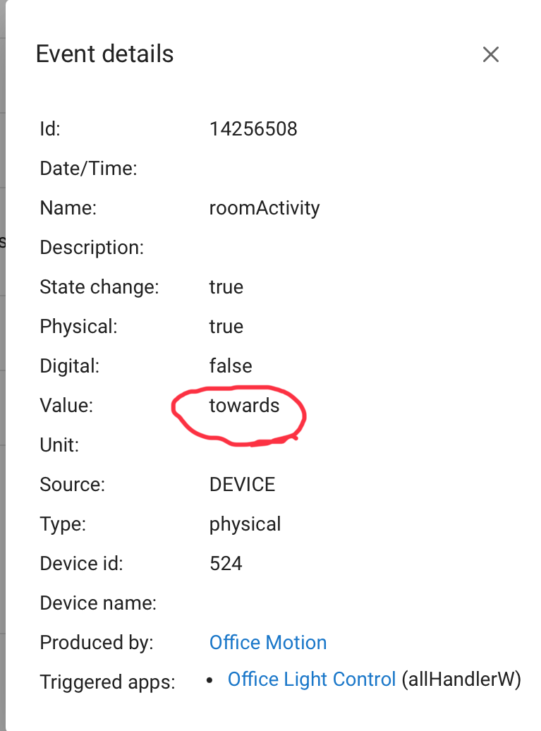

Check out the Aqara FP1. It has ability for away, towards,enter,leave, and other sensing.

Just realized that the FP1 is discontinued. But it also can detect and alert if someone crosses left to right or the reverse.
