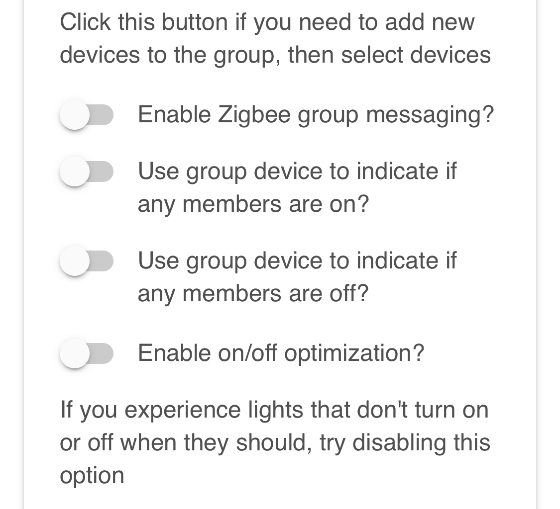

These days, I use my own apps for my mass changes.. But if you are using groups I have found it helpful to turn off:
Hi ... omg! Your mode action app is the missing app for Hubitat!!! This is the way i like it. Easy and clean. Only thing missing is to be able to set dimmers individual .
