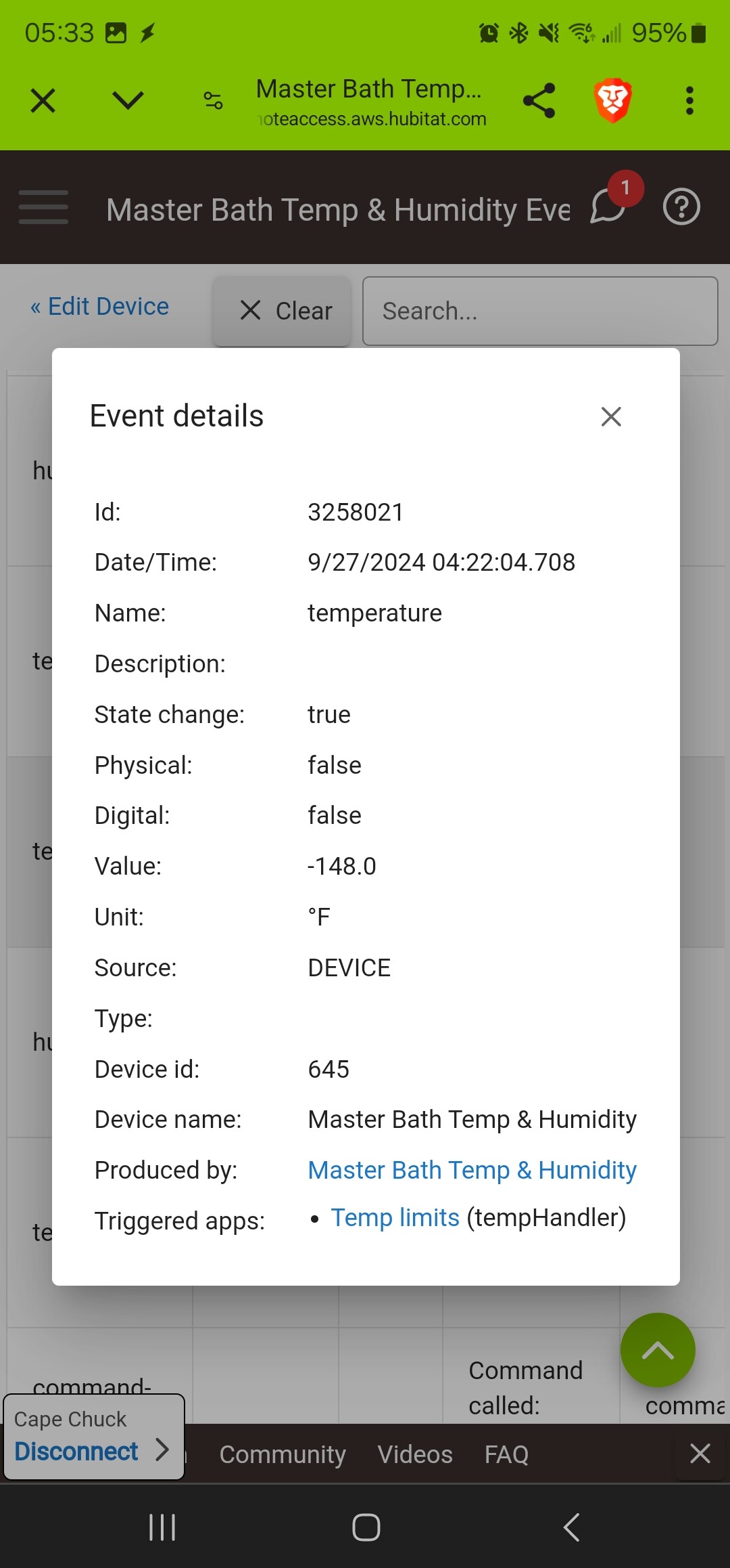

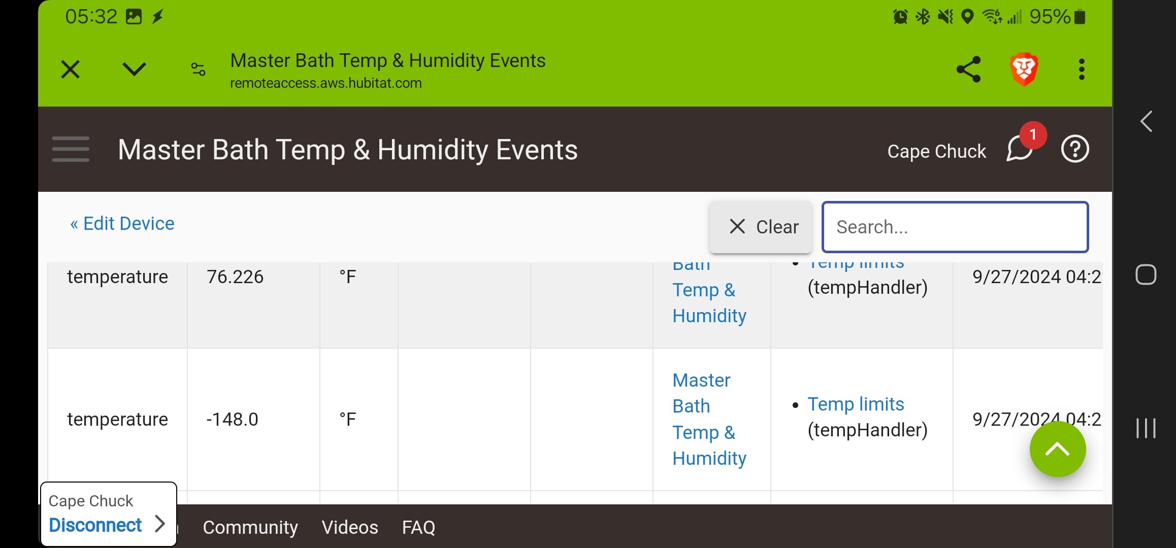

Any idea what might be causing this and a recommended solution?
I'm using the "Xiaomi Aqara Mijia Sensors and Switches" driver for the temp/humidity aqara sensors..
