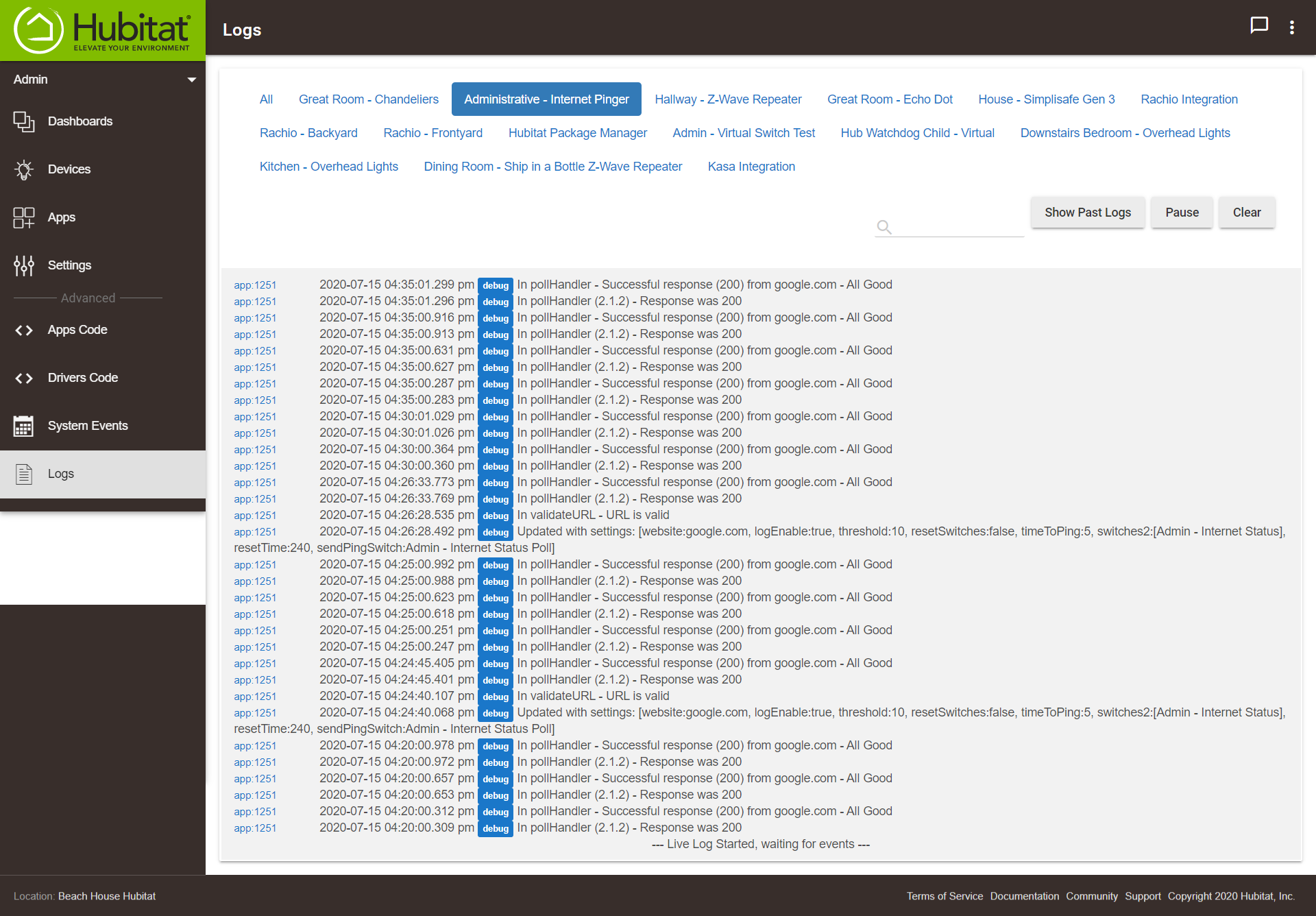

Has anyone experienced issues with this app pinging multiple times per trigger? Attached is a picture of my log, which you can see is sending a request to google 2-4 times per trigger every 5 minutes. Is this the intended activity or is there something I am doing wrong? I reinstalled the app and reinitialized the settings as you can see in the log.
No your not alone! Mine looks very similar to your log about 5-6 pings per session every 10 minutes. Lets hope @bptworld sees our posts and tells us if this is correct
It's not sending the request multiple times, it only sends it once. It must be getting multiple responses from the website. Nothing I can do about that.
@bptworld are these multiple responses from google taxing the hub more and if so is there a particular website you'd recommend to use with Web pinger that would not cause these multiple responses and tax the hub? Much appreciated.
Again, this is nothing to worry about.
