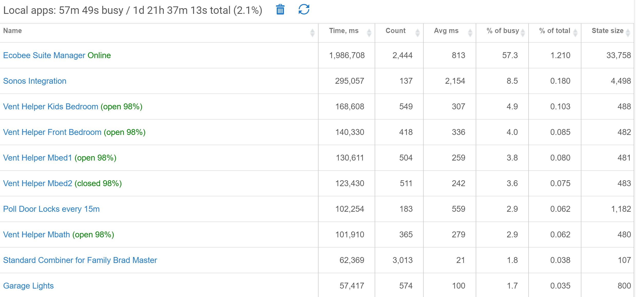

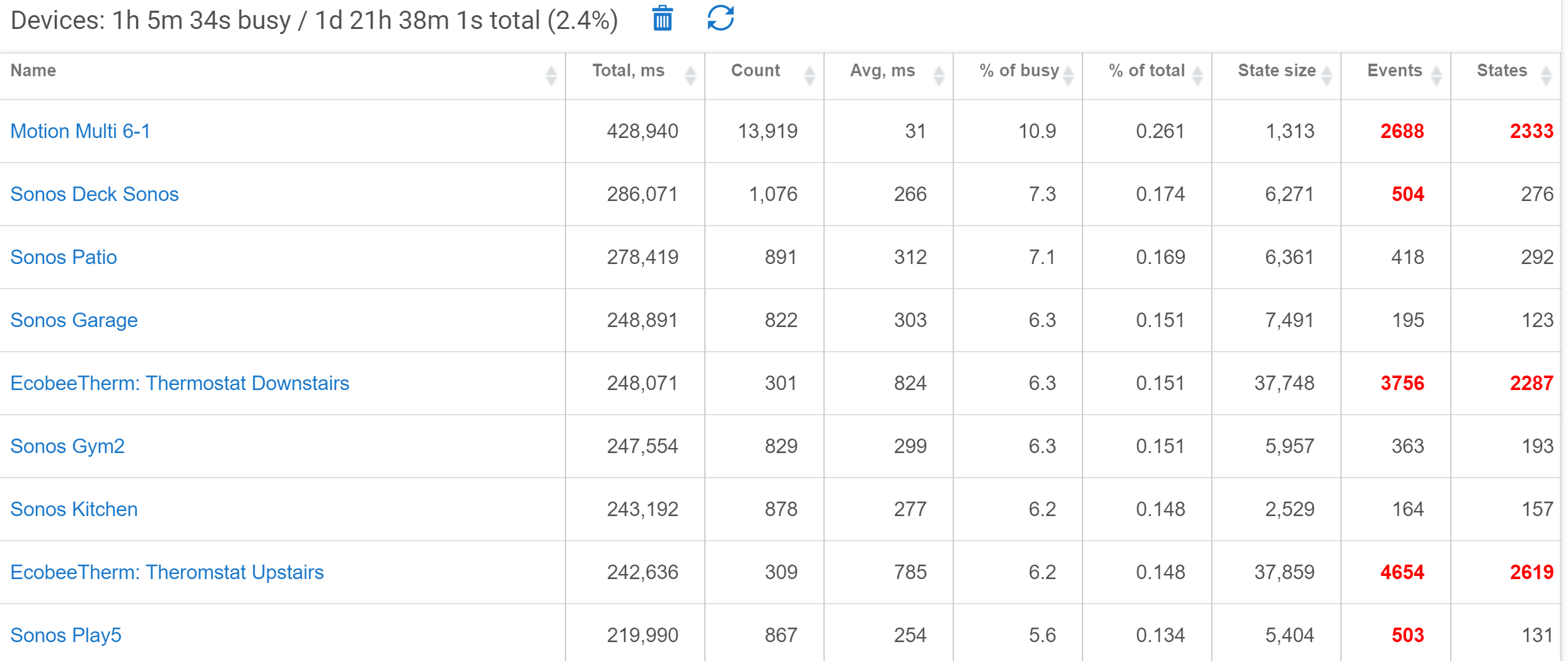

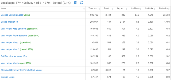

Would you mind posting screen shots of the top of the Device stats and App stats reports so I can see for myself the scope of the overhead? Best if you turn on ALL of the Display statistics options, and try to capture the top 5-10 devices/apps listed?
Thanks!
Had to wait a few days as the hub upgrade wiped the uptime stats. This is with 10 min polling on Ecobee Suite.
Your stats look perfectly normal, very similar to my own stats on two different Hubitats (1 with 1 thermostat, the other with 3). Adding everything I can see together, the total Ecobee Suite is using less than 2% of wall clock time.
FWIW, At 10 minute cycles, your vents could take up to 20 minutes to react to thermostat changes, making vent changes sluggish at best, or useless. I always recommend 1 minute cycle times when using the Smart Vent helper.
I expect that changing to 1-minute cycle times will add minimal additional compute overhead, but whatever it is, that will be the price of automation. Since your total system is using only a fraction of available CPU time, the added overhead isn’t going to slow down your system noticeably. And if you get alerts, I suggest contacting Hubitat Support - the CPU alerts are a new feature, and they may need to tweak the settings a bit. @bobbyD in Support is very helpful...

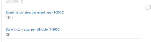

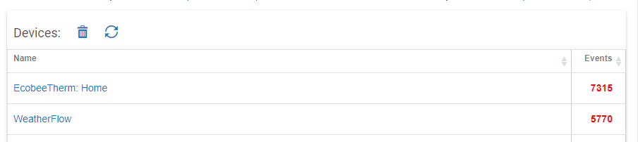

Hey just wondering what folks are using for the log size for the Ecobee Thermostat device? I have the defaults on mine and have the warning showing up that my database is growing:
30/10 should be enough...
Any chance of a setting in the app to adjust these values on the sensor and thermostat devices its added? I just updated mine (2 tstats, 13 sensors) and it was a bit tedious.
I am not aware of any means for an app to control this. The latest release of Hubitat will alert you if the database gets too large, and then will offer you a means to change this default globally. There is also a new app provided by Hubitat that allows you to edit preferences for multiple apps/devices. If those don’t work, you might want to make a suggestion to the Hubitat team.

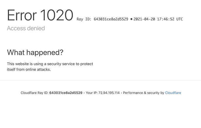

Anyone else just have their credentials get denied? I tried to log back in and give API access but this is what I get when I try.
The error messages that start with 1xxx refer to connection problems on sites that use the Cloudflare proxy. One of them is the Error 1020 Access Denied. This indicates that you've violated a firewall rule and your request is blocked.
I'm getting the same so I'm guessing it's site wide. Not much we can do.
Now the question is - once it resolves, will we all have to "reconnect" or will ES automatically reconnect.

Same with the Cloudflare error here. Looks like they have some sort of spam protection in place.
Yes all those external API calls that are failing must be overwhelming their endpoints.
