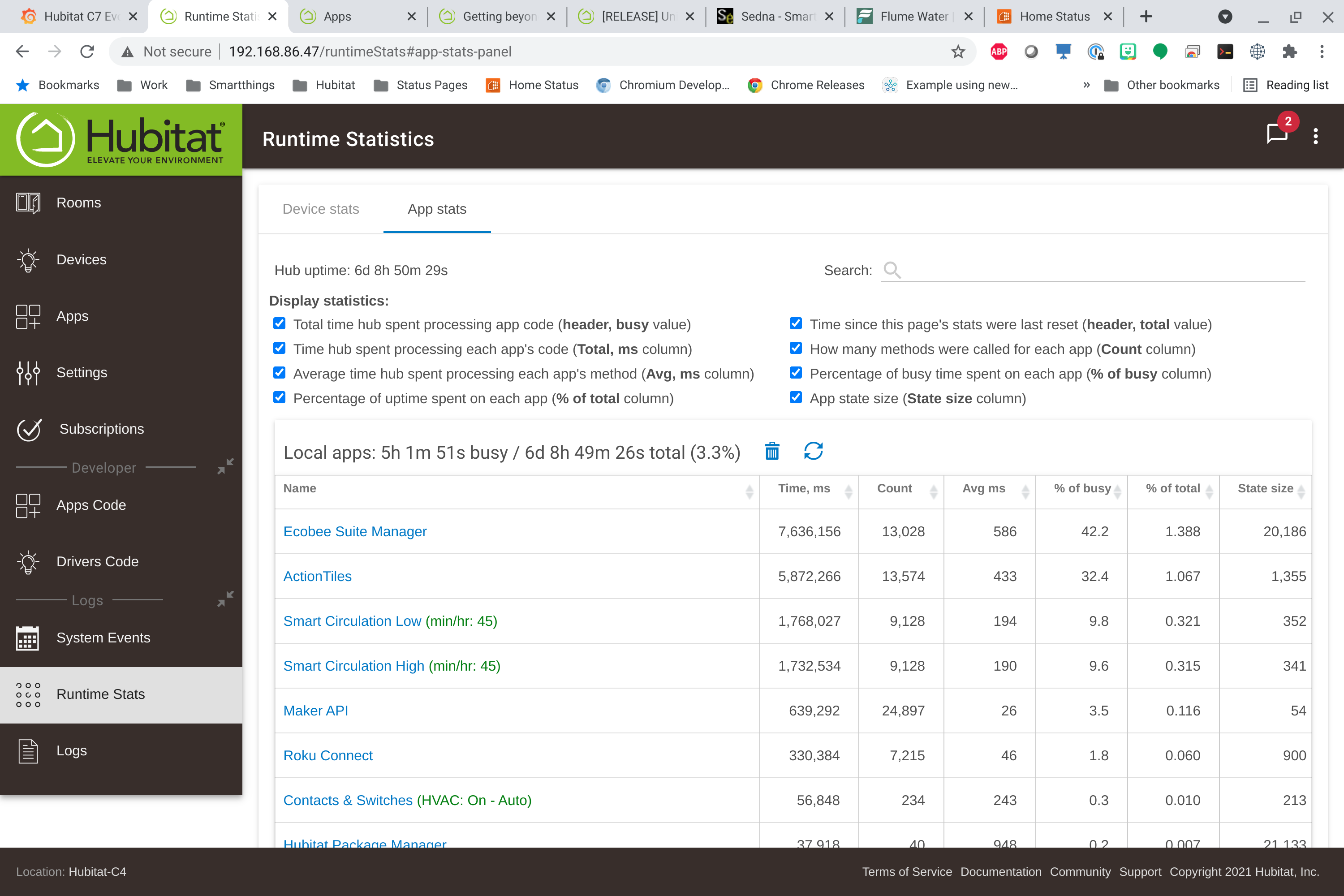

Anybody have experience improving the performance of ES on a hub using the new hub event stats? ES is eating up my hub processing power big time, and I'm not sure what I might be doing wrong. I'm constantly getting "severe CPU load" warning messages from the Hubitat hub. The parent app (ESM) alone is 42% of my hub busy time, The child apps are a lot smaller, but they're incremental to the 42%.
Any ideas on how to address this? I'm all ears.....
It might help if you provide a screen shot of your runtime stats like below. Make sure you have everything selected so all the columns are displayed. This is my hub and you can see in my status the Ecobee Suite Manager is showing % of busy is 42.2% but of the overall time the hub is up it is only 1.38%. The other columns could also be helpful under certain circumstances.
It should also be noted that the runtime stats don't exactly match up to CPU Usage. They are a good way to describe how busy the hub is but some tasks that have allot of wait times like waiting for network response may not match actual cpu usage because they will have elevated run times since they include the wait time for the traffic to travel to the remote devices cloud.
Providing Device stats may help as well with all of it's columns
