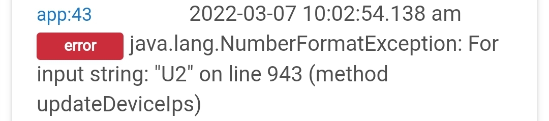

I am on beta. Are you referring to this error?
I'm getting it pretty much none stop.
I have not done any interaction with the app since your last update. This seems to have generated on its own.
Disable the app for now, This should stop the problem. I will load the current version onto my Beta hub and test.
Dave
Will this effect my devices?
Also, how do I "disable" without uninstalling?
Probable reason: Changes in the Hubitat UDP processing in the new version. This is currently in BETA, therefore, a permanent fix is not being developed until all is final.
Impact: Errors while polling for devices within the IP segment during both initial installation and also on the fixLANIP functionality. These errors prevented the app from running properly.
Fixed. In HPM, do a REPAIR. If linking, the link is https://raw.githubusercontent.com/DaveGut/HubitatActive/master/KasaDevices/Application/KasaIntegrationApp.groovy.
Disabling App: Not necessary. To disable an app, go to the APPS page. in upper right hand of the page there is a red "X". Select that and a disable column appears on the left of the app names.
Devices: Not impacted.
Changes:
  • disable fixLanIP in APP temporarily. This automatically resets the IP 's on the devices if there were more than 4 consecutive errors from any one device. Work-around is to run the APP and installKasaDevices (does same thing.
  • Slow Down Discovery process. This had to be slowed down significantly due to the changes in the HUBITAT UPD protocol processing. (this was also the root cause of the first error).
Final Fix: after the new Hubitat version is out of Beta and stable.
