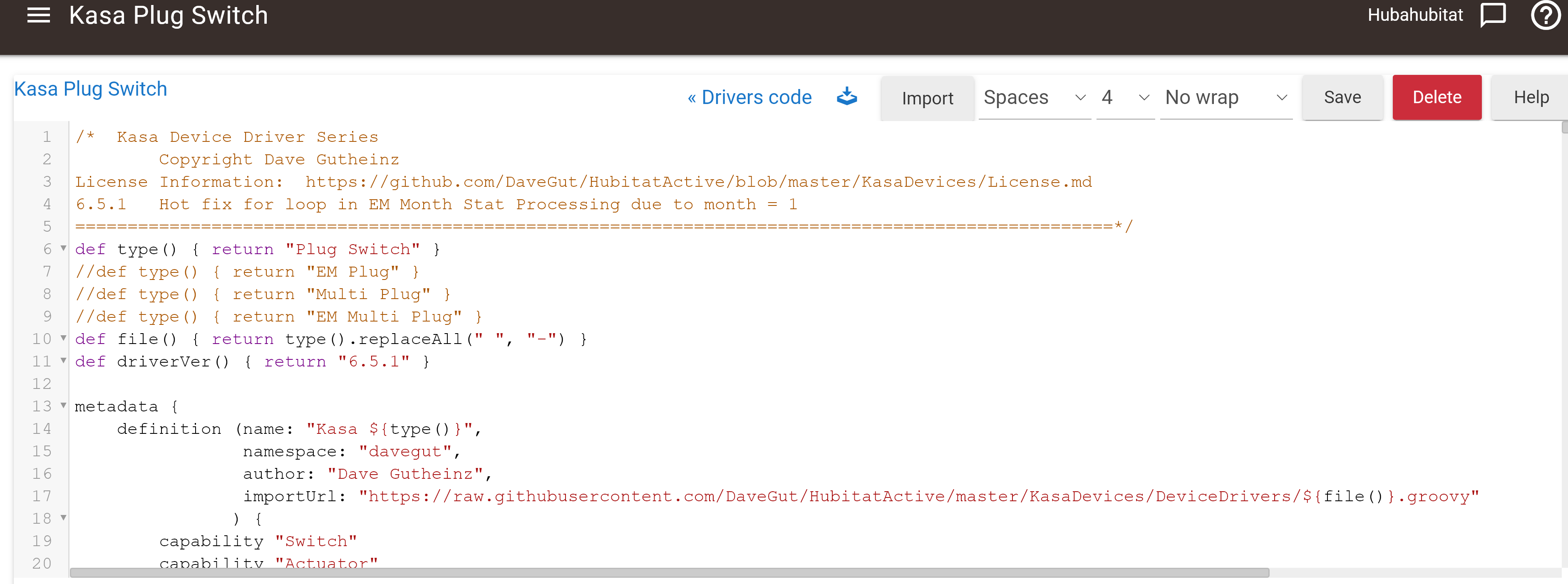

OK. The message indicates the driver is not installed. One possible reason for the HPM error earlier is the driver Kasa Plug Switch is missing from your Drivers folder.
In hpm, try a repair and see if that restores the missing driver.
If not, in hpm, modify the package Kasa and add the missing driver (All Plug-Switches).
repairing didn't work and trying to modifying gave me this message:
Nothing to modify
You did not make any changes.
Is the driver in your folder? If not, you need to get it from the source and place in the folder. I AM NOT the person to ask about HPM.
driver file location: https://raw.githubusercontent.com/DaveGut/HubitatActive/master/KasaDevices/DeviceDrivers/Plug-Switch.groovy
Excuse me while I take this opportunity to thank you for your work on this integration. I've purchased a few different Kasa products and along with your app they are working perfectly.
It is
Only other thing is there is already a device installed with the same Device Network id. other than that, I am lost.
Thanks for your help. I really appreciate it.
