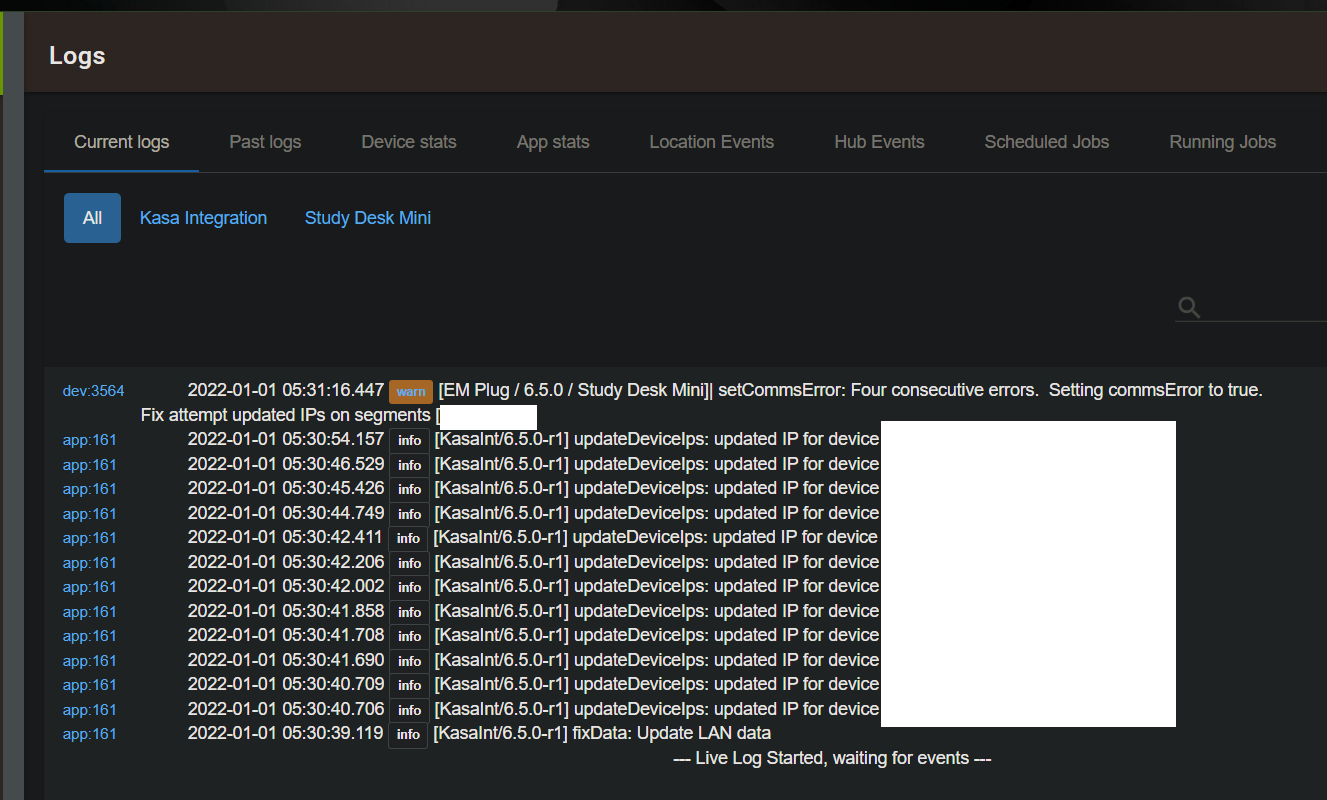

Set up a trace at the three error methods, then started EM function on my HS115. Set poll interval to 5 seconds. Will run for an hour or so and see if any errors generate. Will then induce a comms error and see what happens.

  1. Check a device for Comms Error. (I didn't see this in the log).
Neither did I, nothing in the logs or in the attributes of the devices that I checked (2-3 plugs)

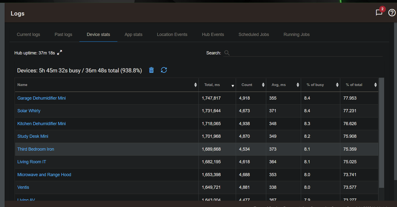

Whatever it is, it's not normal, a C-7 running at 78 degrees C
I chose to reboot the C-4 mid extraction of 124, it was getting up to 90 degrees C.

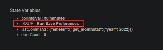

Most seems to be set to 30 min polling, but I saw this on a couple of them.... Is it something I should follow up?

It is an old state that is no longer relevant. I recommend running save preferences after each update; however, for 6.4.3 to 6.5.0 the only critical device is the dimming switch (which implemented new capabilities).
Both the C-4 and C-7 are still running hot with high load. I am thinking I should restart my router..... Will leave it for another couple of minutes, but that is my next approach. The C-7 is only 21% through the download of the 124 update after what feels like 15-20 mins.
My update back to 124 download took less that 1 minute! It could be your router/gateway or it could be a VERY BUSY HUB.
