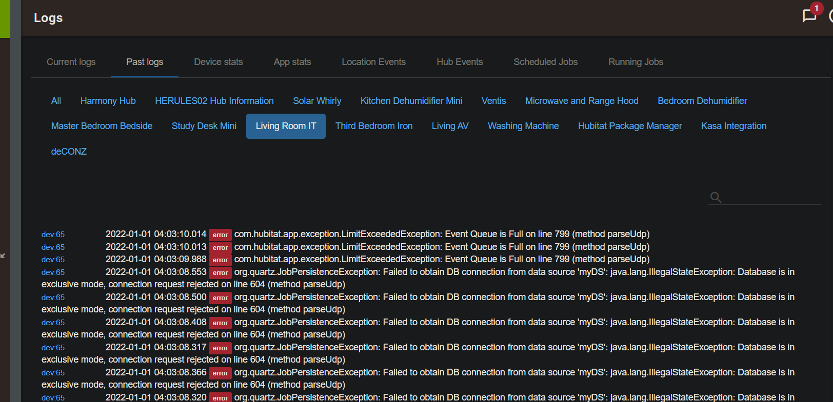

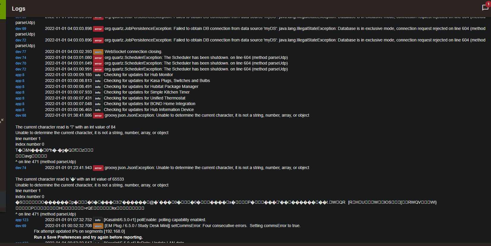

Hi @djgutheinz,
Every chance this issue is at my end and not related to the Kasa drivers, but thought I'd check with you (and others) in case it was.... I saw this error in my logs, could it be something I have done or should change? The same pattern appears in the logs for most of my plugs. Happy to take this on myself as something to follow up or investigate, not expecting it is a problem with the Kasa drivers....
A restart seems to have solved the issue for now...
The preceding messages look like the event database was somehow corrupted or there was a loop in setting an event (every second or so) that would fill up the database.
Questions:
  • Hub version are you using?
  • Kasa Driver version and Device Type?
Dave
The same logs appear in both a C-4 and C-7, both running 2.3.0.121.
The Kasa drivers are version 6.5.0 according to info logs for more recent entries in the HE logs.
I have a mixture of the larger HS110 energy monitoring plugs, as well as the slimmer KP115 energy monitoring plugs. Both are represented in the kind of logs I showed in the last post.
Looks like I have bigger problems....
Error is in the setupEM function (called when you save preferences. I am looking for a loop in that area as well as the comms error area. Additionally, the parse UDP area.
The message with the wierd characters is the pre-decrypted return from the device.
