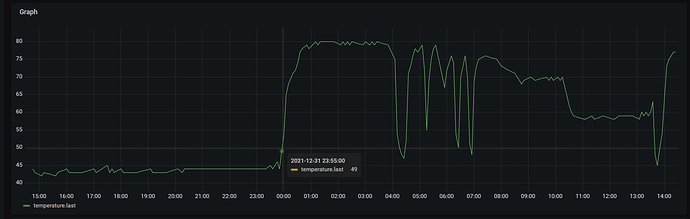

Well.... maybe.... Back at 70+ degrees and 1000% CPU....Turning on debug logging for one of the switches produces a flurry of logs getting the current months energy usage.
The elevated temperature / load did appear to coincide with the new year. Could it be a month 1 issue of some sort?
I don’t like coincidence, looks like you may have something there. Anyway to turn off that calculation?
I turned off the energy monitoring on one of the plugs and restarted the HE hub, seems to have calmed down again for now
