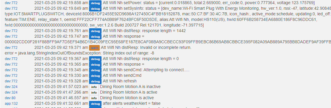

@markbellkosel84, were you using a beta 2.2.6? After updating my hub today to 2.2.6 I am getting these errors as well.
@djgutheinz Seems like something that possibly changed in the groovy back end and caused a bug in the driver. Line 599 of the "Kasa Plug Switch" driver originally is this:
if (response.length() == null) {
I am not sure when or why the length would be null but I guess this was working before? Now the length on these invalid responses seems to be 0, so I changed that line to be this:
if (response.length() == null || response.length() == 0) {
This has made the error messages go away, and if debugging is enabled it is logging the "null return rejected" message which you can see right below that line in the code.

After upgrading 2.2.6.129 im getting these errors and level set is not working: [error] java.lang.NullPointerException: Cannot invoke method toInteger() on null object on line 323 (setLevel)
Try setting preference "Default Transition Time" to 1 second (or greater). I am already working on a permanent fix.
Tell me if it works.

i am still running older kasa integration just local and no reason to upgrade.. as mentioned.. with firmware release 2.2.6 was getting this error everytime a refresh was done on em switches.
turned on debugging and it was because the length was 0, it was checking for a null and returning but not 0.. change the code and added a check for 0 with a return
ie
// ===== distribute responses =====
def distResp(response) {
logDebug "response = $response"
logDebug("distResp: response length = ${response.length()}")
logDebug("distResp: null return rejected.")
return
if (response.length() == 0)
return
didn't add it in the existing if as didn't think it was an error and justified a message.
this was in version 5.3.3 of the em driver and other drivers.

Again, I am aware. The error (in this case) is a nuisance and does not cause any performance nor status errors.
What is happening: When executing the connect or close command, a null/empty response is returned from the device. This used to be returned as null. Somewhere it was converted to zero length.
The next update will correct this - and earlier in the accessed methods.

It was originally for the early Hubitat 2.2.6 users. 2.2.6 uncovered an error in my code that was masked in earlier versions. The initial fix is below (for one driver only). It impacts all my drivers. Out this week with some other fixes.
