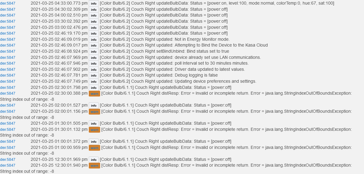

I do seem to still see the -8 error in the logs. I updated the driver through hpm and have tried clicking save preferences and save device on some of the plugs but the warning still appears. Any ideas or was there something I missed?
I too am getting errors. It's not a problem. We love the work you do @djgutheinz.
It's the " Invalid or incomplete return.
error = java.lang.StringIndexOutOfBoundsException: String index out of range: -8"
Yeah, only appreciation from me on the efforts by Dave, I have started writing drivers for others myself so can appreciate the efforts that can go into that.
What device / driver are you using. Can you give me some logs using:
  • turn on debug logging and save preferences
  • Then open the log page.
  • Do a simple REFRESH. Wait 1 minute and do another REFRESH
  • PM me the log. We may have to do some test code.

I am at a loss here. I updated all of mine using HPM at about 2:40 PM my time. Below is a typical past log. It is true for all 21 devices as well which cover 7 of the 8 drivers (no dimming switch).
Below is a typical log (for a bulb here). Same for all. Note that as version go to 6.2, the error stops.
Don't stress Dave, I'll play around with it some more in the next day or two, but am at work now, so will probably be another 10 hours or so before I can look at it again, or if anyone else can take a look and help out....

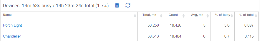

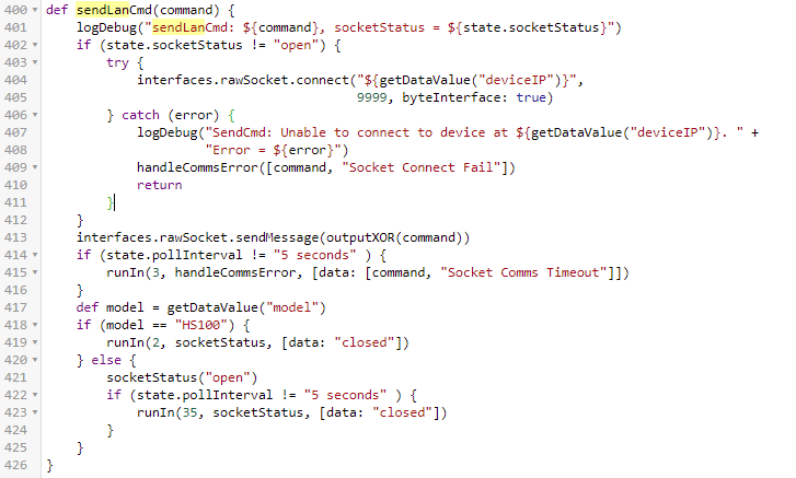

made some minor change, and now with 5 seconds poll, total cpu is only about 0.1% per device
(one is HS200, and another is HS210)
HS200 does not close connection immediately (i have two, and tested many times)
Also with 5 seconds refreshing, the connection is always valid, so skip the handleCommsError,
and socketStatus (which is called automatically by the system)
