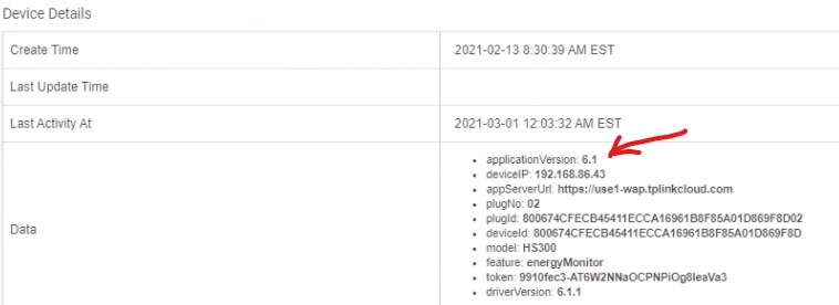

No. I check the manifest and it still shows 6.1.0.

I installed via HPM, then added my Kasa login and token stuff.
I think I may have installed 6.x from the beginning. I only installed it a few weeks ago. I just let HPM update to 6.1 today.

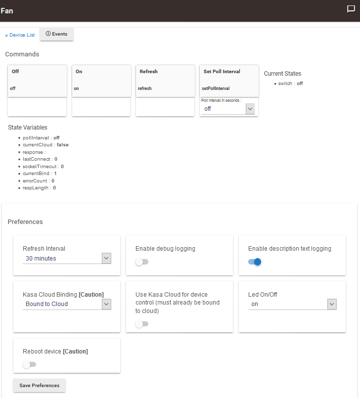

What would be the correct steps to convert my devices to local? (I have one that is inside a nema enclosure outside, so that would be a pain to have to actually access :slight_smile: )
Since I don't know if you followed the instructions, do the following:
  • Open the instructions and follow the steps in the section "Upgrade Instructions".
  • On the device's page, look in preferences. If you see a parameter "Use Kasa Cloud
    • Assure it is set to false (white, not selected)
    • Save preferences
You should now be in local processing. You can double verify this by looking at the state variable "currentCloud". I should be false.
Below is a picture of my Fan, bound to the cloud, using local control.
You should now be under
The update is now complete. Assuming the

Here's something interesting I found (not sure if it's relevant). The app says it's 6.1.1:
Inked2021-03-01 11_04_31-jonathan_LI
But the device says it's 6.1:
