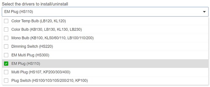

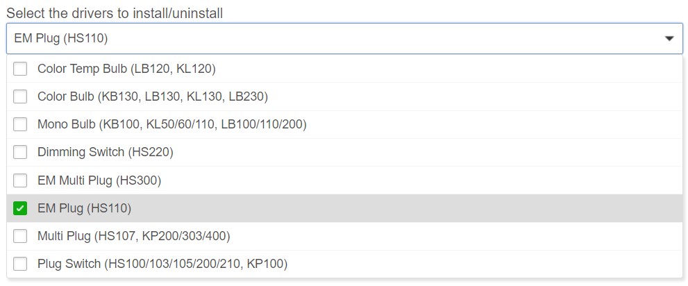

Thanks again for this app! Minor HPM documentation note: the KP115 uses the same device driver as the HS110 per your documentation. However, this wasn't apparent when running the install via HPM as the KP115 is not listed next to the HS110 in the driver load dialogue.

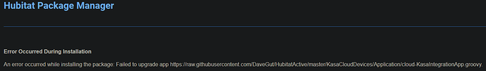

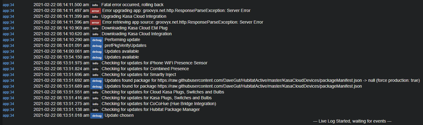

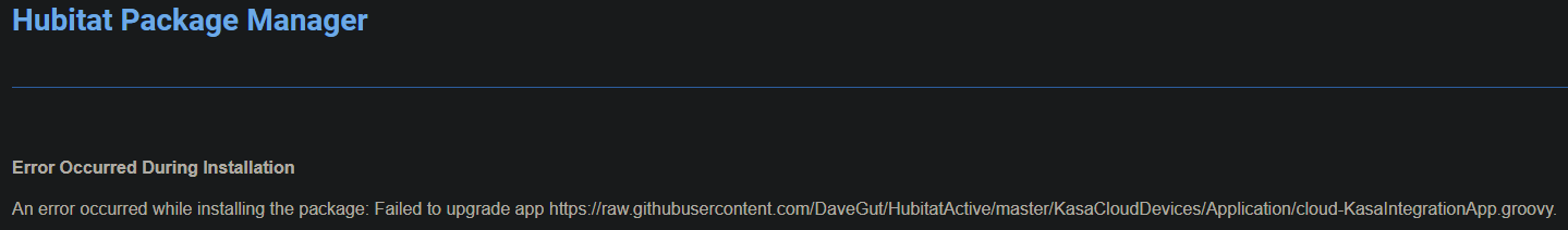

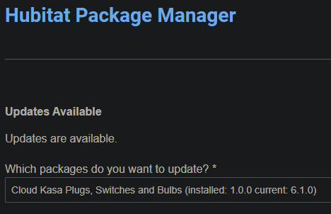

Any idea why HPM might be telling me that there's an update available? I can't see a version newer than 6.1.0 (which I already have installed)
Trying to install this "update" results in a failure.
