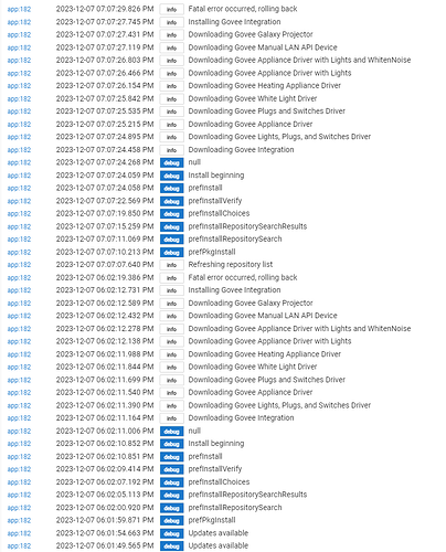

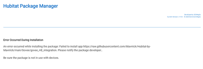

I just tried installing via HPM and I get the error message below. Any idea why and how to resolve this?
That is odd to get that during a install. Generally when i have seen something similar it is because HPM can't get a lock on the objects involved so it fails. Can you tey again and if it fails again go look at your logging to see if there are any errors.

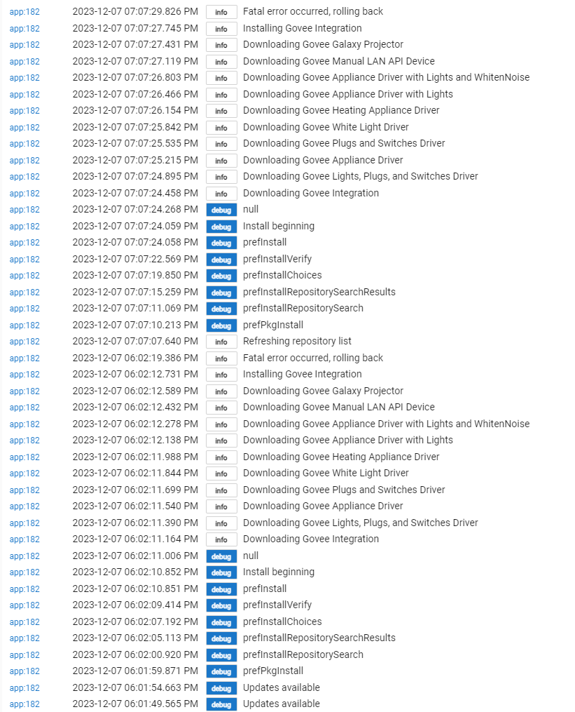

I tried a few times but it keeps failing. Here's what I see in the logs:

Not to derail the govee subject, this also happened to me with a different app that kept telling me there's updates for it. I believe it's HPM issue.
I don't want to hijack this perfectly wonderful Govee topic, but I believe this HPM message is related to the order of upgrade between Platform 2.3.6 and HPM 1.9.0.
I can see from the screen cap that it's HPM v1.9.0, which is correct BUT if you upgraded the platform first (from 2.3.5 or earlier, to 2.3.6) then the Apps list that HPM sees is empty. Duplicate apps will be found in your Apps Code folder.
Ok, the truth is, the code out on github has an error.
unexpected char: '' @ line 1530, column 250.
135:["name":"Christmas Gift", "cmd":['"owABBQICGgAAAAEAAT8/AAAUFL0\\="','"owEAgBQBAP8AAACAAACAACkAAOE\\="','"owIAAQIBfkAA5RQUAfsUBv//AJA\\="','"owMAAAD/AAAAAACLAP8AAAAAACs\\="','"o/+AAACAAQAAAAAAAAAAAAAAAF0\\="','"MwUEkBMAAAAAAAAAAAAAAAAAALE\="']],
at the very end of that line is a single \ and it should be a double, the same as it is everywhere else in that section.
Manually adding the code to my hub confirms it won't compile ... but does after I add that 2nd .
ok fixing.. Sorry about that @csteele
