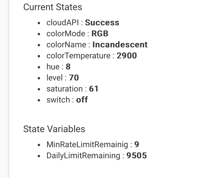

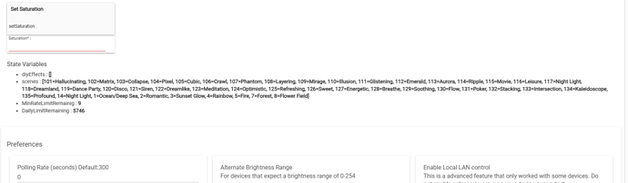

When you have that device open in the Hubitat UI, do you see a list of DIY's and scenes in the state section.
Those errors look like you don't have scenes or DIY's loaded from the Govee Integration App. They are definitely there, but i do not have this device to test with.
Please try this.
  1. Open up the Govee Integration app and scroll down until you find. the button for "Scene management". Click on it to go into the next menu.
  2. Click the button from this menu to "Click her to Reload Preloaded Scenes Information". Wait about 20 seconds before moving to next step
  3. Click on the button to "Click here to update all devices awareness of Scenes"
  4. Go back to the device in the UI and check the States section. It should look something like what is below.
The last update should allow the extraction of Snapshots. Then they are activated the same way DIY's are. One thing I would caution is that the extraction process for Snapshots are an order of magnitude more complex then Scenes or DIY's so it may not be perfect. Just let me know if any problems occur and I will DM you to see if we can figure out why it is failing and how to get it working for you.

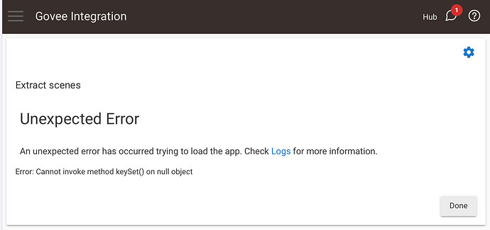

Furthermore while in the Govee scene management page, and clicking on “Extract Scene” I get the following screen (hopefully hat may help you troubleshoot):

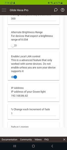

Yes, but based on the image you provided it looks like you don't have acces to any of those functions yet. By chance is your device not enabled for LAN API control. It looks like you are still using the cloud API for that device.
When i ask if LAN control is enabled i am refering to the switch in this image with the IP being configured.
If that isn't done. Then LAN Control functions like those related to scenes and DIY's will not work.
I did not yet setup the device for LAN, so that’s probably the issue. I’ll assign a fixed IP to the light and will connet via LAN.

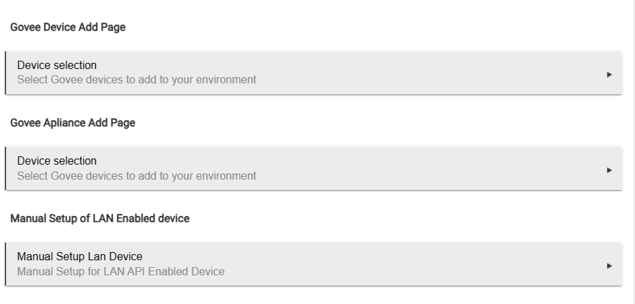

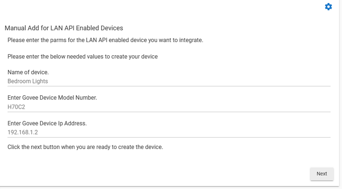

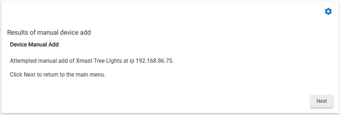

The process to add them would be like this.
  1. Open up the Govee integration app and select the button for "Manual Setup Lan Device"
  1. Now enter the information for the device like below.
    a. The device Name is what you want it to be labeled as in Hubitat
    b. in your case since it is the Christmas tree lights the Govee Device Model Number is H70C2 (case matters). Make sure to replace the example which is what your model number is
    c. Enter the local ip address of the Light device on your home wifi network.
    d. Click next.
You will get a display saying the device was attempted to be added as shown below. You can click on next and repeat the process if you have more then one to add. If done adding click on "next" and then "Done" to exit the app. Then you can go check the device on the device page to see if it is listed.
One thing to keep in mind with devices added this way though is that this won't prevent you from adding them the Cloud API way if the device is enabled for Cloud API as well.
Thank you it works I had to turn on the lan setting on the Govee app as well.

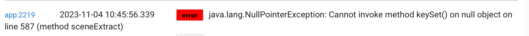

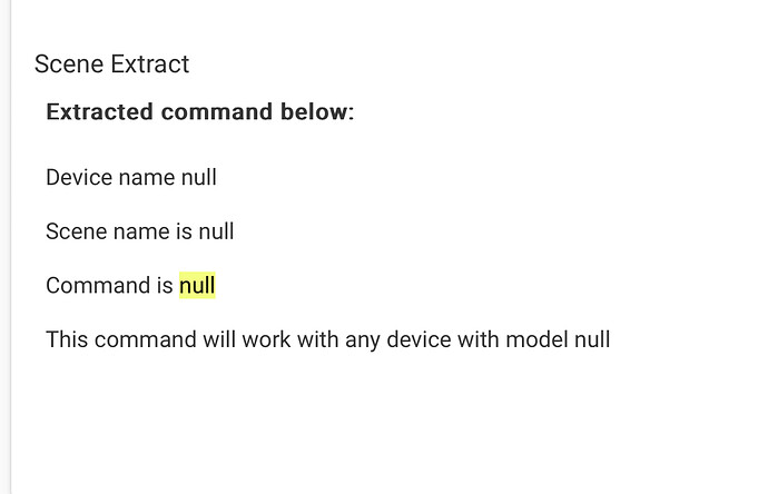

When clicking on the “Extract Scene” button, I get the following error:
I was on 1.0.44 the first time I got the error, then updated to .45 and am still getting it. Recommendations?
I tried initially with the “Default” group, and then created a new “Hubitat” group. Same issue with both.
