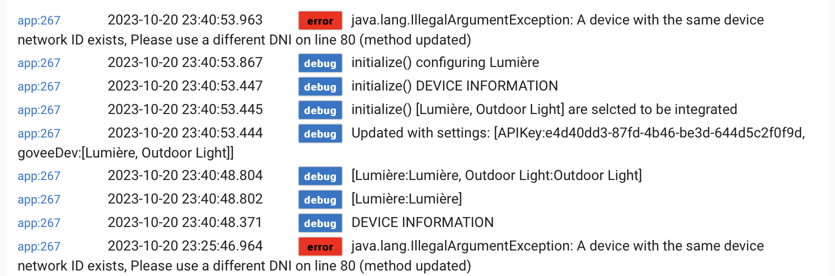

Below is a standard log when trying to add the new device (existing one is called lumière)
That error shouldn't happen as code was added a few versions back to prevent it.
That looks like you are running old code based on what line of code that error is complaining about. Please verify you are running the latest version of the code via HPM or by going to the Github repo and importing the app and drivers again.
Interesting as the package was installed via HPM, and showed as up to date (no update available). Anyway, I used the HPM repair function to reinstall and push the latest version, and everything work ad expected.
Thanks for a great app and awesome support!
You may want to check your HPM install and ensure it is running it's latest code.
