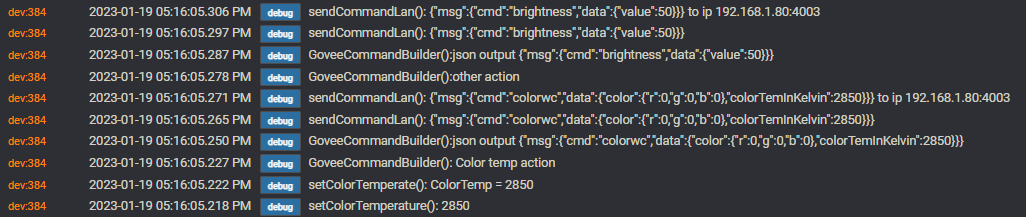

So i just did some testing with the set color command. I can certainly confirm strange results when submitting the setcolor command with similar numbers to what you showed above.
Everything appeared successful, but it looked turned off. I even checked the Govee Home app and it showed the lamp was on so what gives. Well I tried it again and set it to the (value)brightness parm option to 50 and low and behold it lit up. I turned it off and then tried it again at 50 and it lit up again. That disproved one of my theories. The command is working but the question is why is it so darn dim that it looks off when the brightness value is set to 1. I think there are a few things at play here. First thing to understand is we are doing conversions between HSB % scale and RGB. HSB includes a value for brightness variable, but RGB doesn't. Though we call it brightness I don't think it actually translates the way you are thinking in regard to dim level. So, when a conversion is done that level means practically no color is visible and not a dimness level. Think of it like taking a color that is near perfect black and making it 100% dim level. If it is nearly black even at 100% it would be pretty much black.
I tested the setColorTemp value and that seems to work fine from what I can tell and worked every time.
My suggestion is to use the setcolortemp as you have started anytime you want a white light. If you want a color light first set it to the color and then adjust the dim level independently.

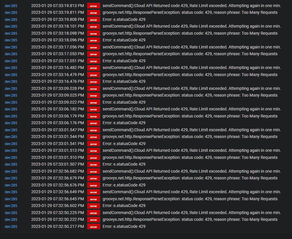

I'm getting rate limited w/ two H6057 speakers. I'm not doing anything that would seem to be particularly verbose with them. However, the logs look noisier than expected:
I have rules configured to toggle these off/on based on wall switch taps. So, nothing that would be sending commands with any amount of frequency that would run afoul of the rate limit I wouldn't think. Any ideas?

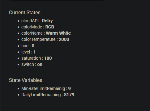

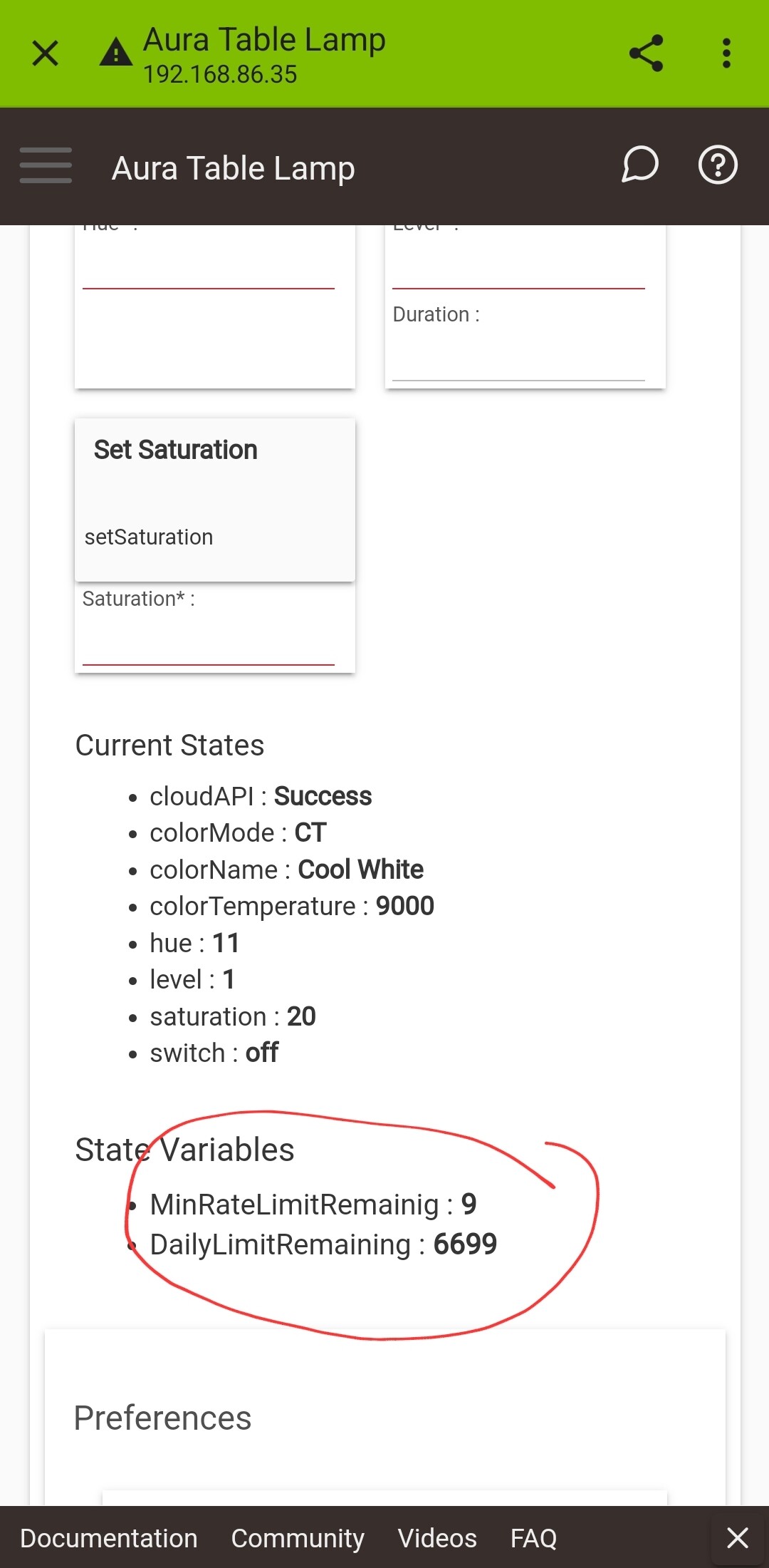

What do you have polling set to? If you ope.n up the device it will show you what your API Usage is like. What numbers are shown there.
default, 300 sec
What is said in the driver in the space in that image above.
Is it still happening?
