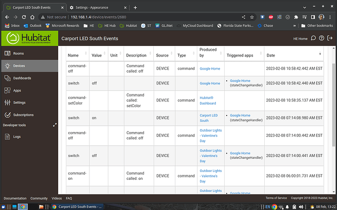

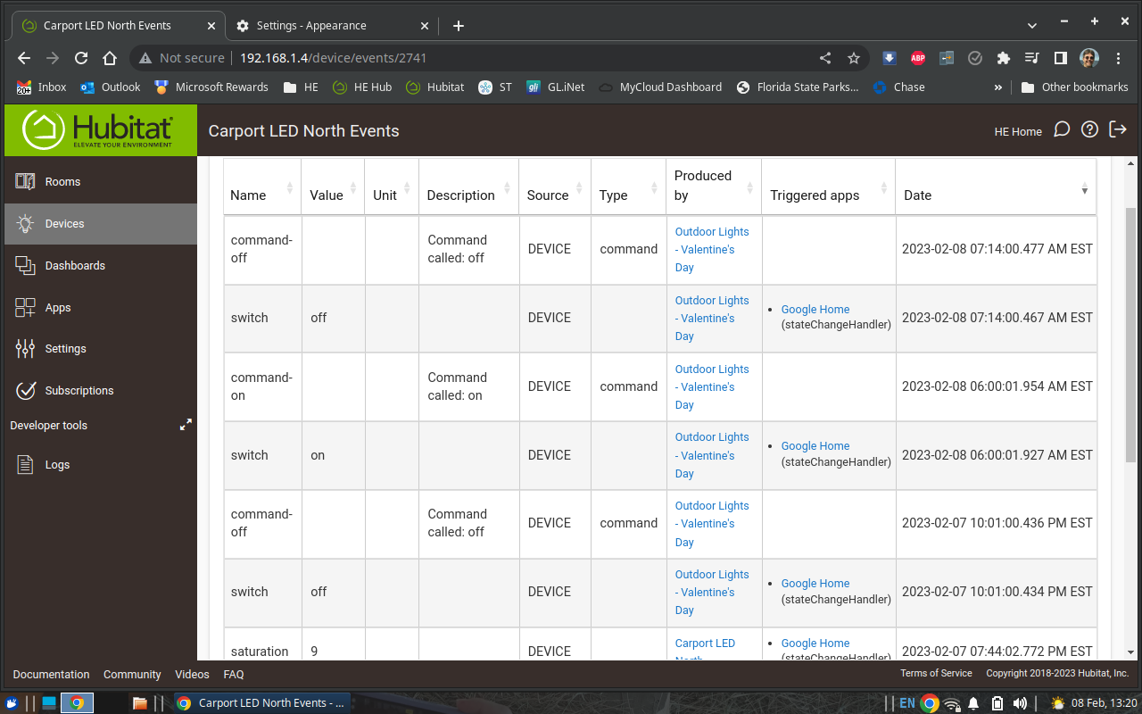

I do have an issue that I have had since the beginning I'm trying to track down. Maybe you can help. I'm finding that sometimes a light strip will turn back on after being turned off. This is not isolated to one single device, I've seen it on both H6172's running via local in the driver. It saw it happened on one strip this morning so I captured the event logs for both strips.
Here is the event log of the device, Govee North, that worked correctly and stayed off.
Here is the event page for the device, Govee South, that turned itself back on.
What stands out to me is when the switch on command is issued at 7:08:14 it is from the strip itself (not the valentines rule in rule machine), there is also no command-off in the logs. I manually turned the strip off at 10:58.
I did not turn the strip on manually at 7:14:08 via the device page (if that's what this is indicating). This does not happen each time the lights are turned off nor does it even happen everyday. I can do a second check to make sure the lights are still off but I don't want to do that unless I have too.
Any ideas? Thanks!
When you noticed that were the lights actually on, or were they just reported as on in HE.
I suspect this is related to timing of polling the Govee Cloud API vs the device taking place. What is your polling interval?
What i am thinking happend is that the Govee api didn't get the update for the device to be turned off. So HE sent the command to turn it off and then 8 seconds later it polled the cloud API and got a on state and then the driver updated the device state in HE back to on, but the device was not actually turned on.

The light was on and the valentine scene was doing its thing.
This has me stumped. I'm not really sure how to troubleshoot this. Would debug logs be of any help? I can set an alarm to turn on debug before the lights turn off at 10pm in the evening.
Polling is set to default
Using local
debug logs may help. Or more completely the logs from the whole hub. It may be good to see what is happening on the entire hub.
The Polling process, based on the code shouldn't change state, which is why I asked about that timing. But if it is actually turning on then something has to be telling the device driver to turn it on. Only other time I have seen something similar was when I was experimenting with using Node-Red to replace cloud polling by polling the device directly with the LAN. I found that because of how the LAN polling worked with Node-Red that anytime the node red instance restarted it would turn on the lights.
The sporadic nature of this means it has to be something strange and a timing thing. Could you try turning off polling completely and see if that will solve it? The logs don't actually show a command being submitted, but just the event being sent. That shouldn't exactly turn the lights on.
I'll turn off polling. I'm also going up see if I have some camera footage ofThat period and see if the light actually turned off.
I don't know if this helps or not. The light did not shut off when instructed to to at 7:14. I confirmed this by watching camera footage.
