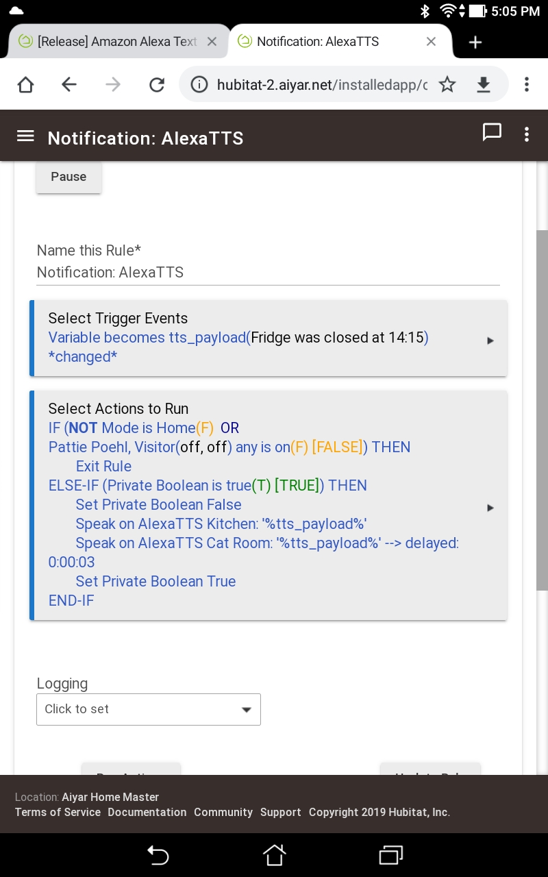

So, this where I did something "smart". All my TTS automations set a global string variable to the value of the desired TTS.
Then I have a single rule that is triggered whenever the string variable changes and sends the string variable to the speech device.
So, I have to change the speech device in a single rule and all my TTS will work again (albeit coming out of different speakers).
Wish I would have thought of that :thinking:
The "All Echos" (announcement) isn't adding the additional text to what's spoken.
Not too late to change - here's my rule
That is now on my To-Do list for this weekend. :+1:
I might try adding a number or device name to the text string and then parsing it to determine which device to send it to.
