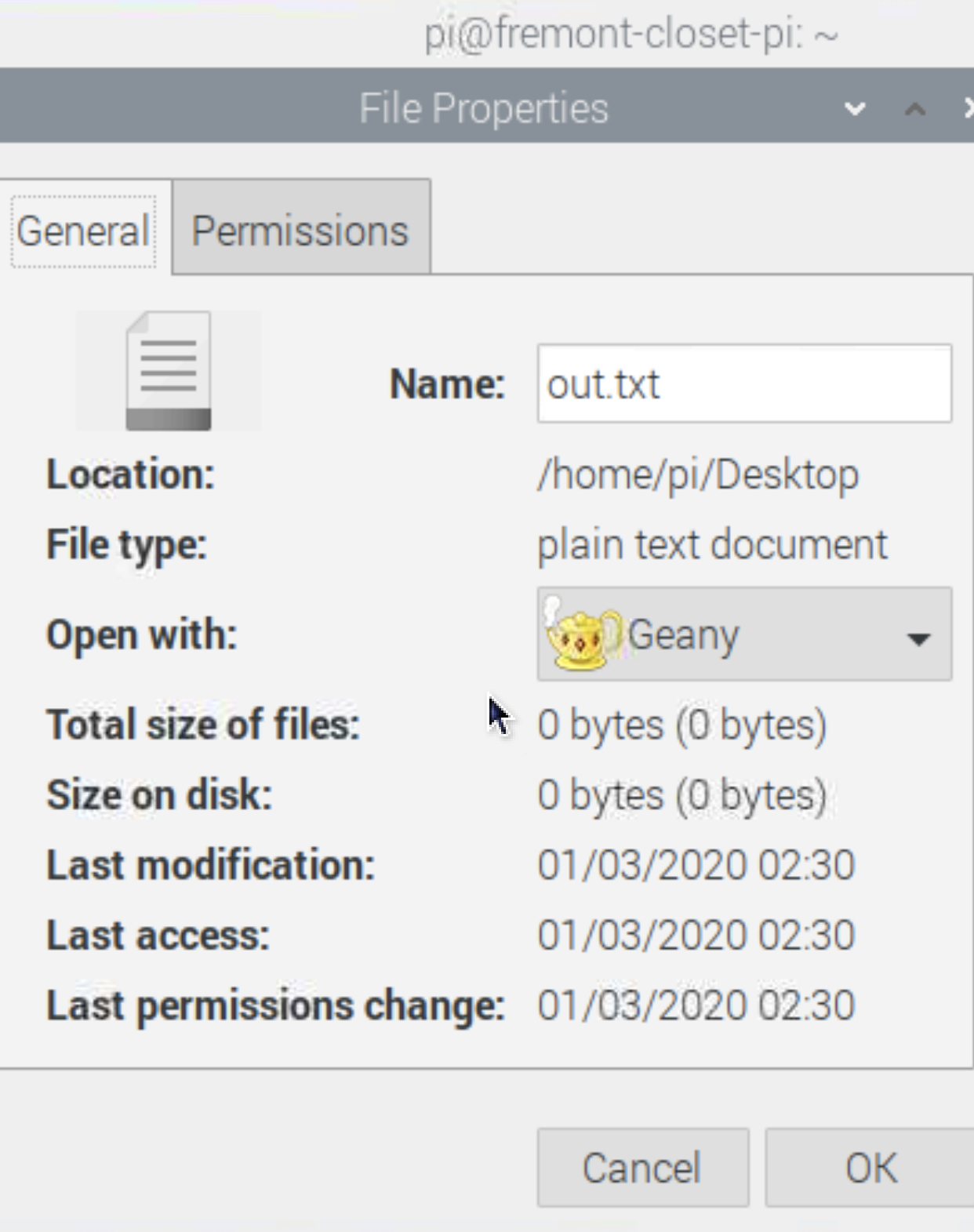

Well the Pi user has full root access to PM2. I can open a terminal window and enter pm2 restart AlexaCookie (and it will restart).
Edit: let me redirect the output from crontab to my desktop to see if it runs.
30 2 * * * pm2 restart AlexaCookie >> /home/pi/Desktop/out.txt
Will give this a try.

I'm out of ideas. Just one last question - are you directly putting that command in the crontab, or are you executing a shell script with that command from crontab? I actually do the latter.
In the olden days, cron didn't like spaces in the command, and I got into the habit of executing shell scripts from cron. I thought that was fixed a long time back, but who knows ....

I’m putting it directly in crontab. I can try having it call a shell script file instead.
So I redirected the output and it did create a file at 2:30 AM but the file is empty. Is that to be expected?
No. Create a shell script like this and execute that via cron:
!/bin/bash
/bin/date > /tmp/alexacookie.txt
/usr/local/bin/pm2 restart AlexaCookie >>/tmp/alexacookie.txt 2>&1
(replace the path to bash, date, and pm2 to be appropriate for your system).

The node services you use will be different, but AlexaCookie should be the same. I put the date command to get a timestamp and confirmation that the cron job ran. And the output from pm2 is redirected to the same file.
Edit - make sure the shell script is marked executable. And put the entire path to the commands.

For some reason "AlexaCookie" stopped running as "pm2 list" had an empty result (thus the bash script didn't execute correctly) so I relaunched the application by performing the following
pm2 start AlexaCookie.js (when in the "AlexaCookieNodeJs: directory)
pm2 startup
pm2 save
The cron job will hopefully run tonight and I will report in the morning if it was successful.
UPDATE: it worked! Thank you for the help!
