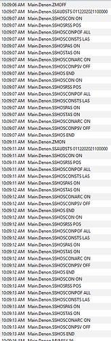

My Denon Receiver connected to Hubitat using this driver creates 18+ log entries per second when playing music. If there is a way to ID which version of the driver I have, please let me know how.
Today, for the first time ever, I happened to look at the logs while the receiver is playing and was shocked at the amount of activity the Hubitat is logging while the receiver plays. I presume I have something incorrectly configured, but since I barely got the thing connected, I'm now throughly beyond my expertise. What setting do I need to fix?
There does not seem to be a toggle for turning on or off debug, but even if there were, wouldn't that just mask all this traffic? I'd like to reduce this excessive traffic.

The way I play music is all the CD's are ripped to files copied to an SD card, which is in an old Android phone that takes SD cards. The phone has Kodi on it, which I use to send the music to the receiver.

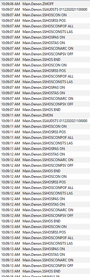

Here is an image of the Log:
(All of the Debug entries are the AVR-1912; the blacked out entries are where the artist, album or song are reporting on the Hubitat log;
the only other entries are changing lux at a MultiSensor; blacked out part is part of name)

8+ events per second on the Hubitat, repeatedly every second, from the same device, when I've not set up the device to have such activity, seems excessive to me.
If the Denon API is intended to work that way, I'd like the Hubitat driver to have the ability to either turn that off or have the Hubitat ignore it because that is alot of processing.

8 events per second is a lot for a human to process, but it’s not necessarily a problem for a computer.
I think you may be assuming there is some kind of problem here when none exists. It likely has nothing to do with how you personally configured the integration on your hub.
That said, you should be able to turn off debug logging if you don’t want to look at all those debug events in the hub log.
It appears as though @abuttino has already incorporated that change into a new version of the driver that hasn’t been released yet, based on his last post from just a few weeks ago.
ETA: in fact if you had just reviewed some of the prior posts in this thread since the beginning of this year you’d see that there’s already been a discussion of this.

Seems like maybe I'm the only one still using this driver! I had some issues with the Denon not communicating with Hubitat, so I asked the gods at aistudio to take a look at it. Here's their interesting reply (seems to have worked for me!):
Denon network cards are notorious for "hanging" on the Telnet port while still responding to standard HTTP/App traffic.
  • The fix: "Reboot" the AVR. Powering it off via the remote is just standby; you must physically unplug it from the wall for 30 seconds , then plug it back in. This flushes the network card and frees up the locked Telnet port.
