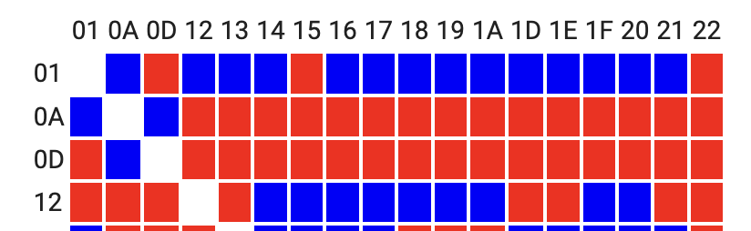

You can also use the Topology Map (red/blue grid) to see which other nodes those consider to be neighbors, you can post that as well if you want.
Dang, they see each other as neighbors. That's going to be hard to remove. Usually the only time you can remove from the hub is if the only neighbor is the hub itself.
