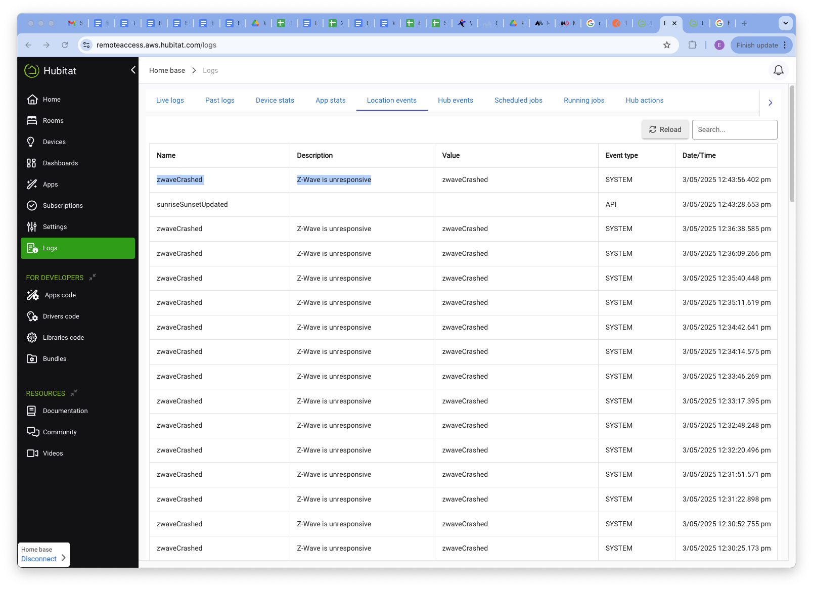

I believe the zwave radio in my hubitat is dead. I have tried the shutdown and pull power for 30 seconds to no avail. Everything was working a couple weeks ago and then I noticed none of my zwave switches work anymore. Log screenshot attached. I updated to 2.4.0.151 to see if this would resolve the issue, no luck. Hardware is C-8

One reason behind zwave crashes is a malfunctioning zwave peripheral that inundates the hub with zwave transmissions.
If I had to guess, that underlies what your hub is experiencing.
GE/Jasco switches/dimmers that fail are notorious for triggering this failure.
So it took two weeks to notice they had stopped working? Usually people notice a total Zwave crash pretty quickly.
Anyway, it does seem like it tries to start twice a minute and immediately crashes, so it never really starts, but all we have is that one log screenshot.

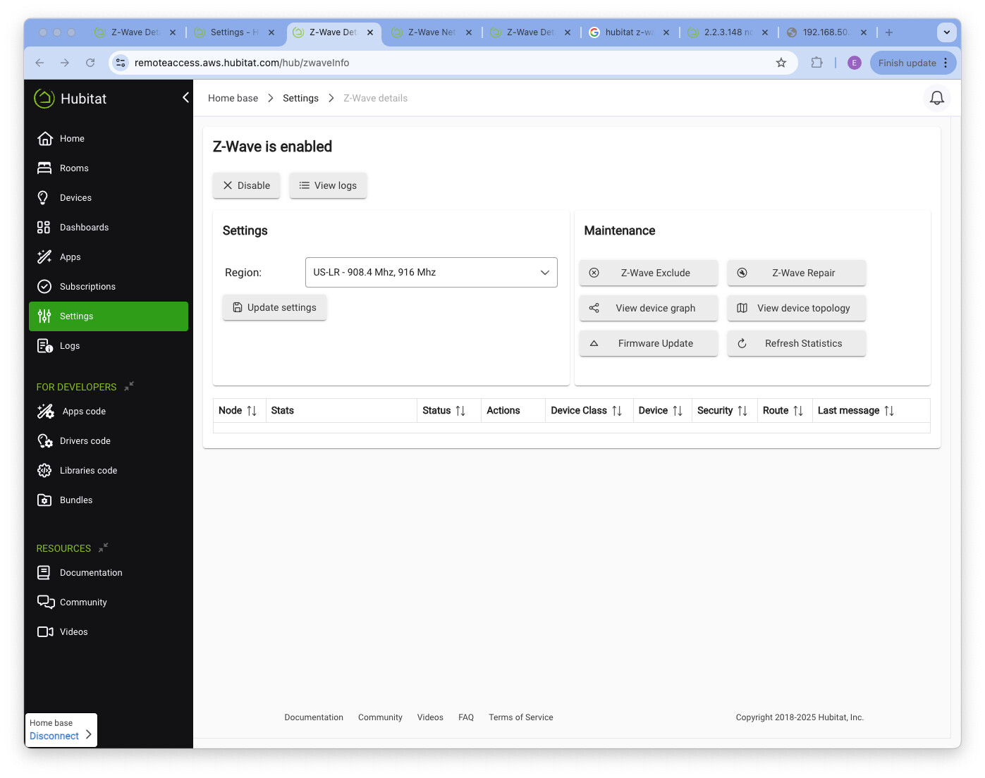

Either way, you can also provide more screenshots here, like of the zwave logs under settings-zwave, and the Zwave settings page and the device graph.

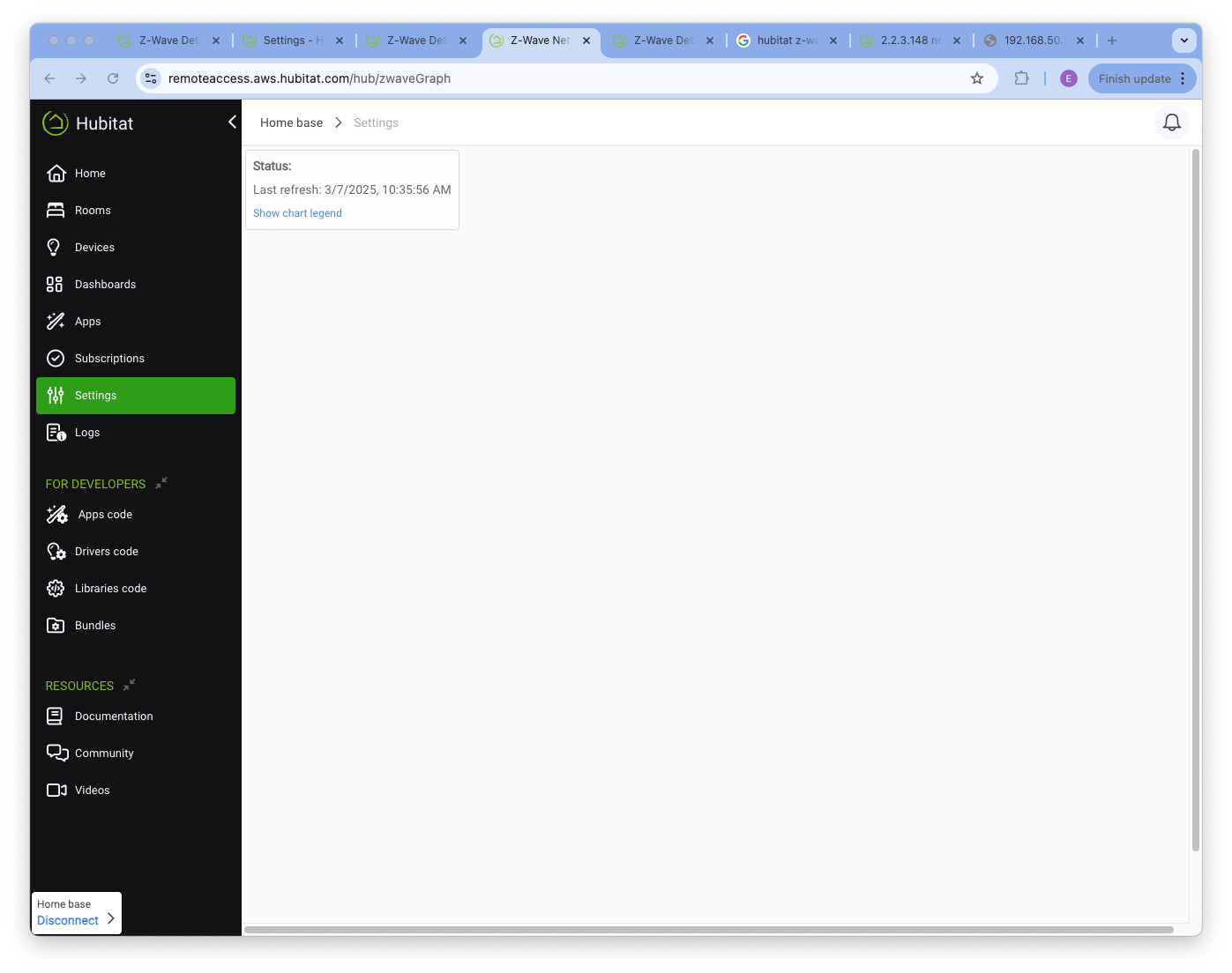

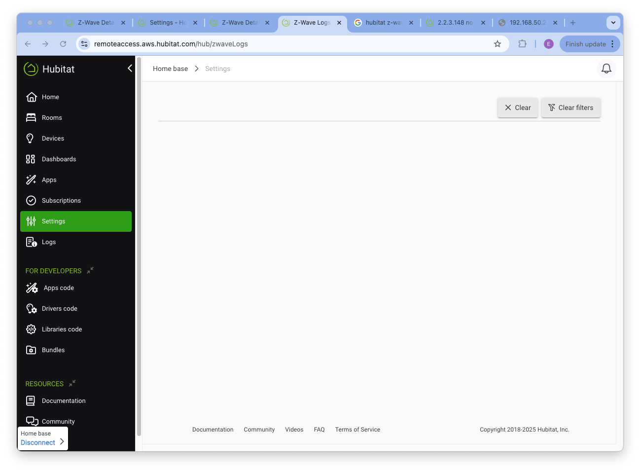

I disabled all the zwave switches in the hubitat and the errors stopped. I then turned them all on one by one. No error messages. unfortunately none were working either. Then the error returned the next day. Unfortunately the zwave logs, zwave stats, and zwave graph are blank. Does not matter if the error ie being generated or not. Unfortunately I never looked at these pages when everything was working fine. Thank you for your help, any other suggestions would be appreciated.

I would suggest shutting down, cut power, turn back on and immediately go to Zwave settings and click View Logs on the Zwave page. See if a device is constantly spamming the mesh. I personally use a zniffer, search that term on the community, but the Zwave logs should provide some clues if you have a faulty mesh.
