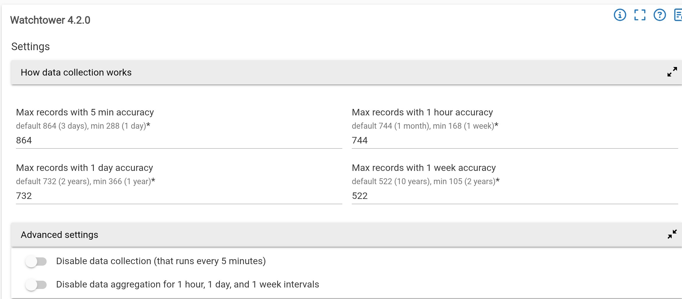

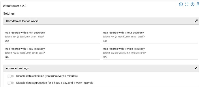

I just recently started using this:
You set limits on the number of records for the files for 5 min/hourly/daily/weekly and it rotates the old records out as the new ones come in.
That looks like Watchtower has some built in methods for downsampling. I wonder what logic it uses for each of these accuracy buckets. Like how does it determine what value to put in their. or is it just the current value in those increments.
If it is some kind of downsampling that is pretty cool they have it built in for numeric metrics iike temp, humidity, and CPU usage. May not work well for things that are states like a contact being opened/closed. Do you know if it does the same accuracy/reduction for those kind of metrics?
Update** I downloaded Watchtower on my dev hub to take a look at it. It is a interesting solution. It does explain the accuracy buckets a bit more in the App. It states the app takes a average from the previous bucket for it's interval. So the 1 hour bucket would take the average of the 5 min interval from the last hour, the 1 day woud take the previous days 1 hour averages to come up with the 1 day average, and so on. That completely aligns with the Downsampling i was refereing to.
