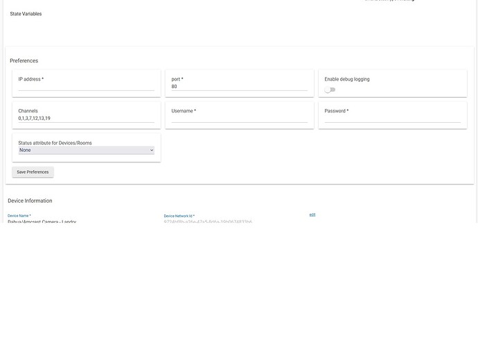

I just added an attribute to return the channel number (0 relative) because I found that rather than having each camera defined as a device, I can just define the NVR and it will pass the motion and IVS events from the camera thru to Hubitat.
In my setup, I only care about IVS events where a human or vehicle has caused the event.
When that happens, I get a push notification, a "spoken" notification and the appropriate zone is indicated on my HomeAssistant floor plan.
I still need to do some testing, but this means that each wired camera can be accessed thru the NVR and does not need to be an actual network client.
I added the ability to select only certain NVR channels for event processing. For a camera, you can use 0 or ALL. Still testing this on a local copy.
I also set the driver to subscribe to only some events related to motion (VideoMotion, SmartMotionHuman, SmartMotionVehicle, CrossLineDetection, CrossRegionDetection).
This reduces the amount of work the hub has to do since it ignores all of the other events.

Did you ever publish this update on HPM that allows for using only NVR and subscribing to the appropriate channels - vs having the discovery create devices for each camera where the Hubitat hub then reaches out to each camera directly?
My experience is that using the NVR-only (and subscribing to the channels) is much more accurate vs connecting to the cameras directly.
At least it seems that the integration via HACS in Home Assistant uses the NVR-only mode and in general, I've found to be more reliable than on Hubitat. Ultimately, I'd like to remove HA from my setup - so curious about having this functionality on Hubitat so I can test and see if things improve.

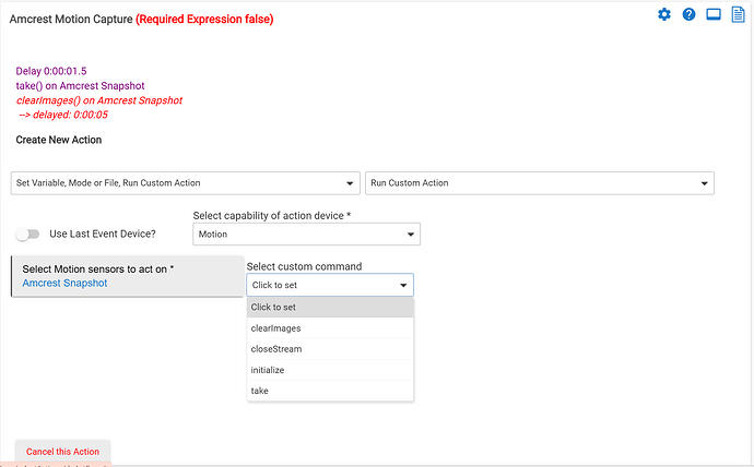

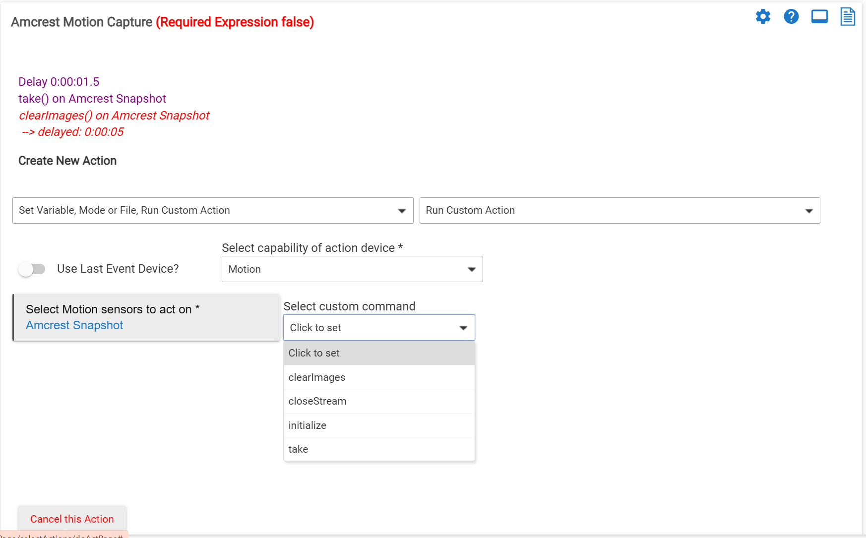

I am a newbie to Hubitat, and am struggling a bit to set up a RM rule to periodically do the "take" command for cameras. There's just enough delta in how RM offers choices now that I am unable to follow the example syntax above. I have a periodic trigger set u. I have chosen "Set Variable, Mode or File, Run Custom Action" => "Run Custom Action" as the action type I will create. What on earth should I choose for "Select capability of action device"? Nothing in the dropdown looks appropriate.
Not exactly sure I understand your question, but . . .
Since I wanted the "take" Custom Action when motion was detected on the camera, I chose the motion event of the "Select capability . . ."
example?

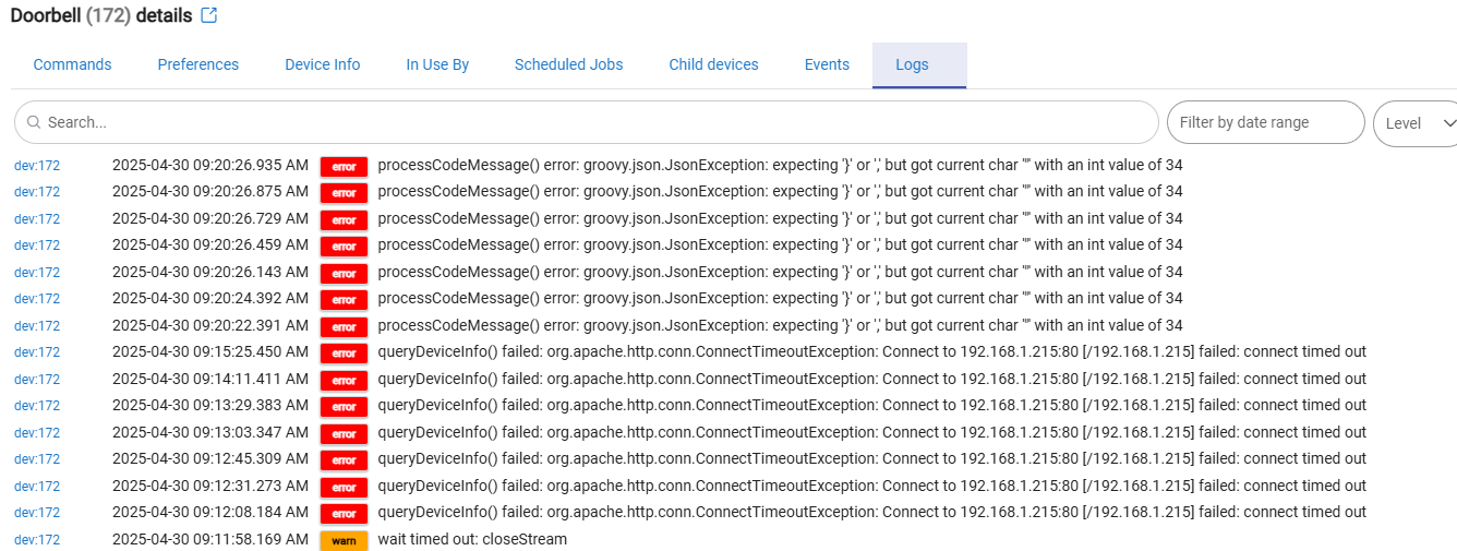

I wondering if you can point me in the correct direction. I installed the AD410 with your driver last year and all was good. Recently, I have been getting lot's of errors. Could you please review the screenshot and let me know your thoughts?
It look like to me that one of your camera is no longer online or you have an setup with an ip address where it couldn't find the camera on that ip address.
I thought that also but I checked my regular camera app on my phone and still accessed it that way. I also checked direct access to it via a chrome browser from my Lan.

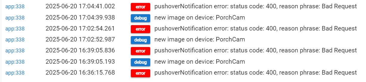

Hello all
Was enjoying the app for 2 years in simple implementation: 'Take' on the camera > image via pushover. Worked like a charm. a couple days ago stopped working. Log shows:
Other notifications (text) via pushover with the same userKey/APItocken are fine.
I re-installed and re-configured the driver and the app - result is the same.
Could someone point me in the right direction?
I know for sure that Image Server code did not change.
It is unlikely that Pushover API has changed (?)
Is it Hubitat interface modifies request on the way out?
@tomw any help?
