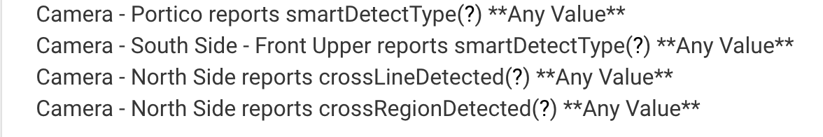

I also have the following Rule built:
But I don't see that rule being triggered. Am I missing something, or should that Rule pick up on the "smartDetectType" and trigger?

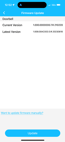

Ugh. So I dutifully went to the Amcrest website here looking for earlier firmware versions. This site says the latest firmware is V1.000.00AC002.0.R.20230810, so I downgraded to the only older version they have online which is 1.000.0000012.0.R.221201. Still couldn't connect via your discovery app or manually with your driver.
So then, ever the glutton for punishment, I called their customer support number which was surprisingly open on Sunday. Once I got to someone who marginally knew the product, they claimed that discontinued local API support was "just a rumor" and that it wasn't true. I tend not to believe that they know what they are saying. Still, they suggested I hard reset the device, so I did. Still no joy with connecting.
Curious if you or anyone has figured out which products or which firmware releases work and don't work? Wonder if I would've been safer just buying the AD110, for example. Appreciate any ideas.
I have a copy of the first firmware when AD410 was first released that was sent over to me by Amcrest support. You can request for it from them but I received mine back years ago from them so I am not sure if they are still offering it to those who request for one.
Thanks @techbill, but I am embarrassed to tell you that I was the problem. I was using the wrong username. For those that follow, you can't use the username from their mobile app -- you have to use the username for the camera/doorbell itself. Amcrest defaults to "admin" at shipping. Duh.

I got my Amcrest AD410 doorbell fully working thanks to @tomw and @techbill. Thought I’d share what I learned for those that follow. The first item probably only applies to morons like me….
  1. When you provide your username and password to the driver or discovery app, make sure you use the device/doorbell’s username, not the username/email address you created in their mobile app. The AD410 is shipped with a default username of “admin”. Others will have to comment whether the same is true for AD110–I dunno. Just don’t do what I did by using the username you setup when adding your doorbell to the Amcrest mobile app. It won’t work.
  2. Amcrest has had an on-again, off-again, now on-again affair with support for their local API. You must use the proper firmware on the doorbell for @tomw’s awesome integration to work as follows:
  • the latest AD410 firmware, 1.000.0000002.1.R,build:2023-08-19), works
  • the 2022 firmware does not work
  • the 2021 firmware reportedly works but I haven’t independently validated this.
You can find out what firmware the device is current using by going to the Amcrest mobile app, selecting your device, clicking on the gear in the upper right corner, then clicking the “Firmware Update” option a little more than halfway down the page. You’ll get a chance to see what version of firmware you are on currently prior to upgrading or downgrading if you so choose.
Follow the instructions here to get and apply different firmware to your doorbell. Changing firmware on your device is very simple and quick if you just follow the instructions — so don’t get intimidated.
