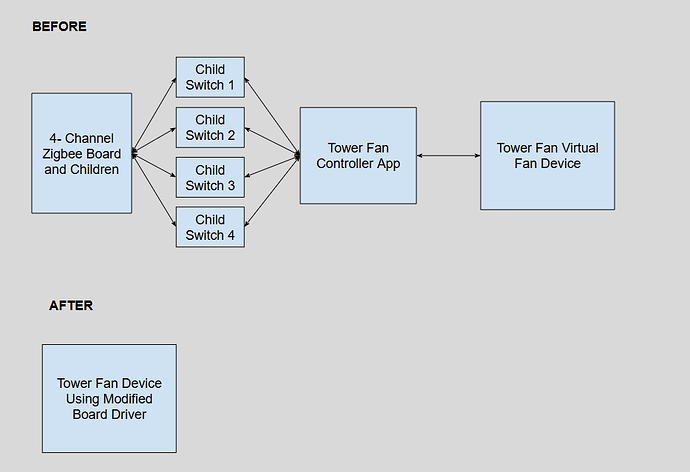

As I have been making dumb devices smart with the Zigbee 4-channel boards (various brands, MOES, etc), I've wanted a custom driver for these boards that I could modify into an actual device.
Example:
This is my use case for the modified drivers, with the Tower fan as an example:
I am now converting a Swamp Cooler to Zigbee using yet another one of these boards. I wanted to get out of the device <-> controller <-> virtual device setup I have been using.
I am currently rewriting my Tower Fan controller to all be in one single driver that controls the fan endpoints directly. That will be easily modified into the swamp cooler driver to control fan speed and turn the water pump on and off.
Here are some drivers AI produced for me.
This one is a drop in for the built-in driver. It creates the children in the same way, so it can literally replace the built-in driver that is already being used with a board, and still use the same children. For new devices, it will create the children:
Custom Zigbee Multi-Endpoint Switch

This Driver does not create the children. All the endpoints are controlled from the single device driver using commands.

And now I have a Swamp Cooler Device Driver for the board :sunglasses:
Speeds: Endpoints 1-3
Cool: Endpoint 4
There was an issue with parse() method from Deepseek, I fixed it in the Swamp Cooler driver so the board buttons or board rf remote can control the cooler.
