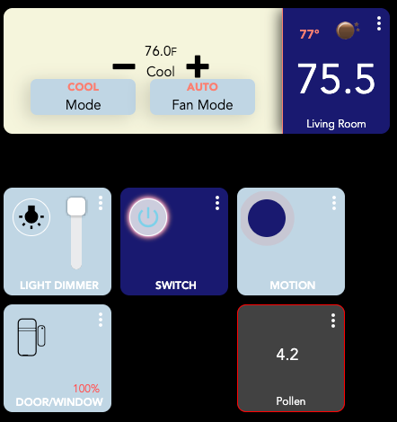

Custom colors for specific device tile
I've searched and unfortunately I haven't found a specific answer, but as far as I can tell it is not possible, but wanted to post to make sure.
I know I can change specific templates tile colors using customColors in the JSON settings, but if you want to change for a specific device only based on state this isn't possible?
I have tried CSS styles as well in combination with state. I was hoping that device state would be part of the CSS generated by Dashboard, but state only gets added in the tile-primary area of the tile.
Is the only way to achieve this to create a custom template, say clone the "switch" template and then have custom colors added in the JSON config?

Yeah, I can change the color of a tile, but not based on the state (on, off, enabled, disabled, etc.). As noted above, the only place that Hubitat places the state in the DOM is in inside the tile. I can only change the tile background color based on state for an entire template, not a specific tile.
I may have found a CSS solution after all. Still testing to do, and again Hubitat if you are listening, it would be nice to have the device state further up in the parent DOM so it would be easier to do, but after digging out my old website tricks notes, I found a pseudo class that may do the trick.
This searches the current DOM element for an occurrence of a specified child, I included the full class reference that the state style class is assigned to just in case, not sure if .tile-primary would be needed until I see how dashboard tiles are rendered for other devices??)
#tile-5:has(.tile-primary.off) {
    background-color: rgba(255,0,0,.5) !important;
#tile-5:has(.tile-primary.on) {
    background-color: rgba(0,0,255,.5) !important;
This seems to do it! At least it works on my browser devices using the latest browsers (ios, chrome). :has() - CSS | MDN
Although there are some limitations, I’ve successfully worked with nearly every tile I’ve encountered so far, including handling transitions between states.

I just discovered this post. This is great. I was seeking a solution for a contact sensor which required a simple edit.
#tile-5:has(.tile-primary.closed) {
#tile-5:has(.tile-primary.open) {
My ultimate goal is to mod the CSS so a tile's background-color remains constant and the color of the icon changes relative to the switch/sensor state. This gets me moving in the right direction.
