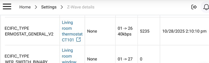

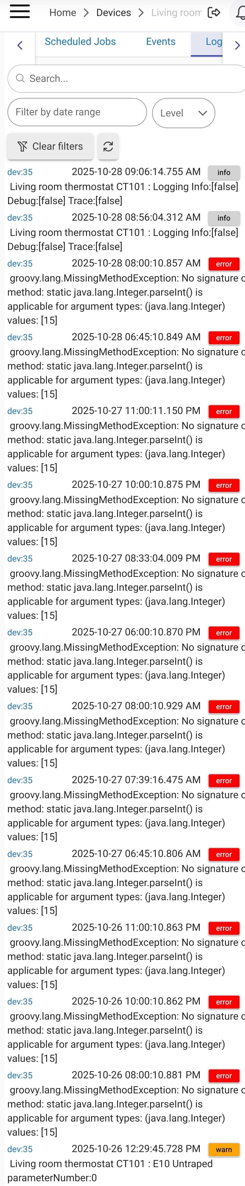

Hi, having trouble all of a sudden on my C8 hub, and Radio CT101 zwave thermostat. Everything's been working fine, but randomly everything got very sluggish to respond to apps/commands.

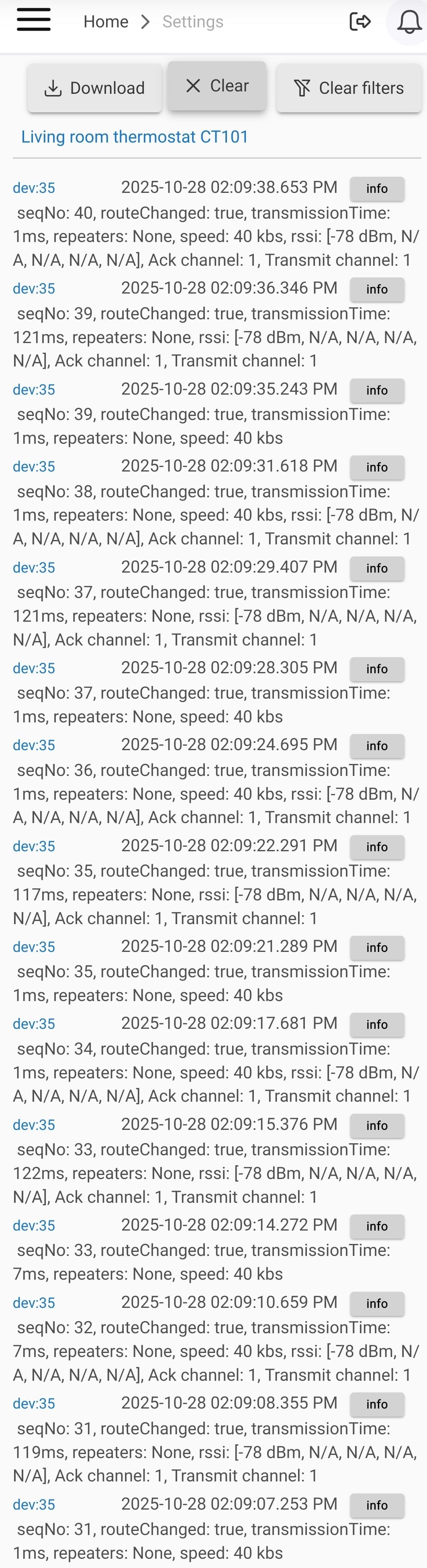

I think the thermostat is stuck in a loop about route changes, but don't know what to do about it. It's a "hardwired" thermostat, with batteries. I tried new batteries in case it was something that easy. Also tried rebooting the hub with no luck.
I've looked at general logs under "past logs" and everything seems ok, but when looking at live zwave logs there must be a problem. I tried turning all logging off under the thermostat preferences tab in case that's clogging it up. Any help is appreciated, thanks!

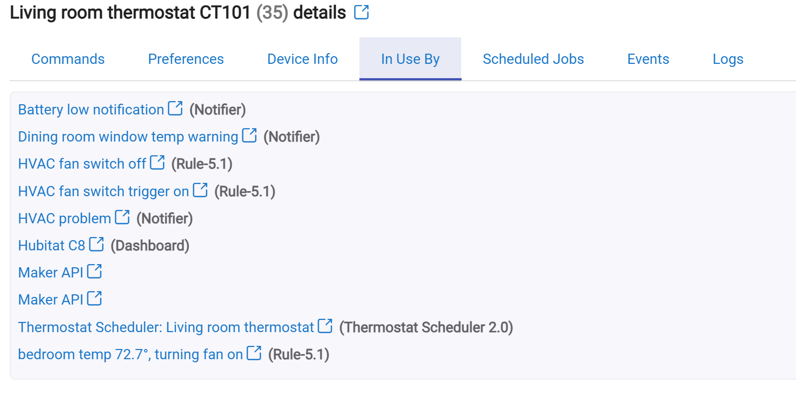

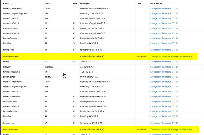

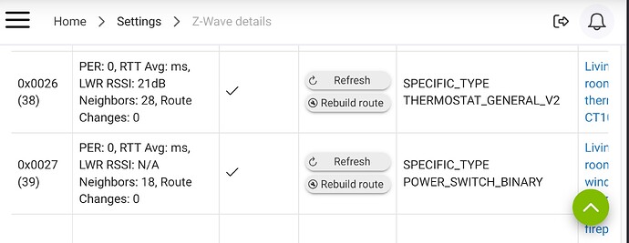

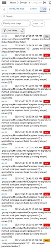

First screenshot is from the zwave log page. Second two are the zwave device page details (living room thermostat ct101), and the rest are from the logs on the device page next to events.
About seven hours later. Still seems to be doing the same thing, now it shows a crazy amount of messages in the zwave details.

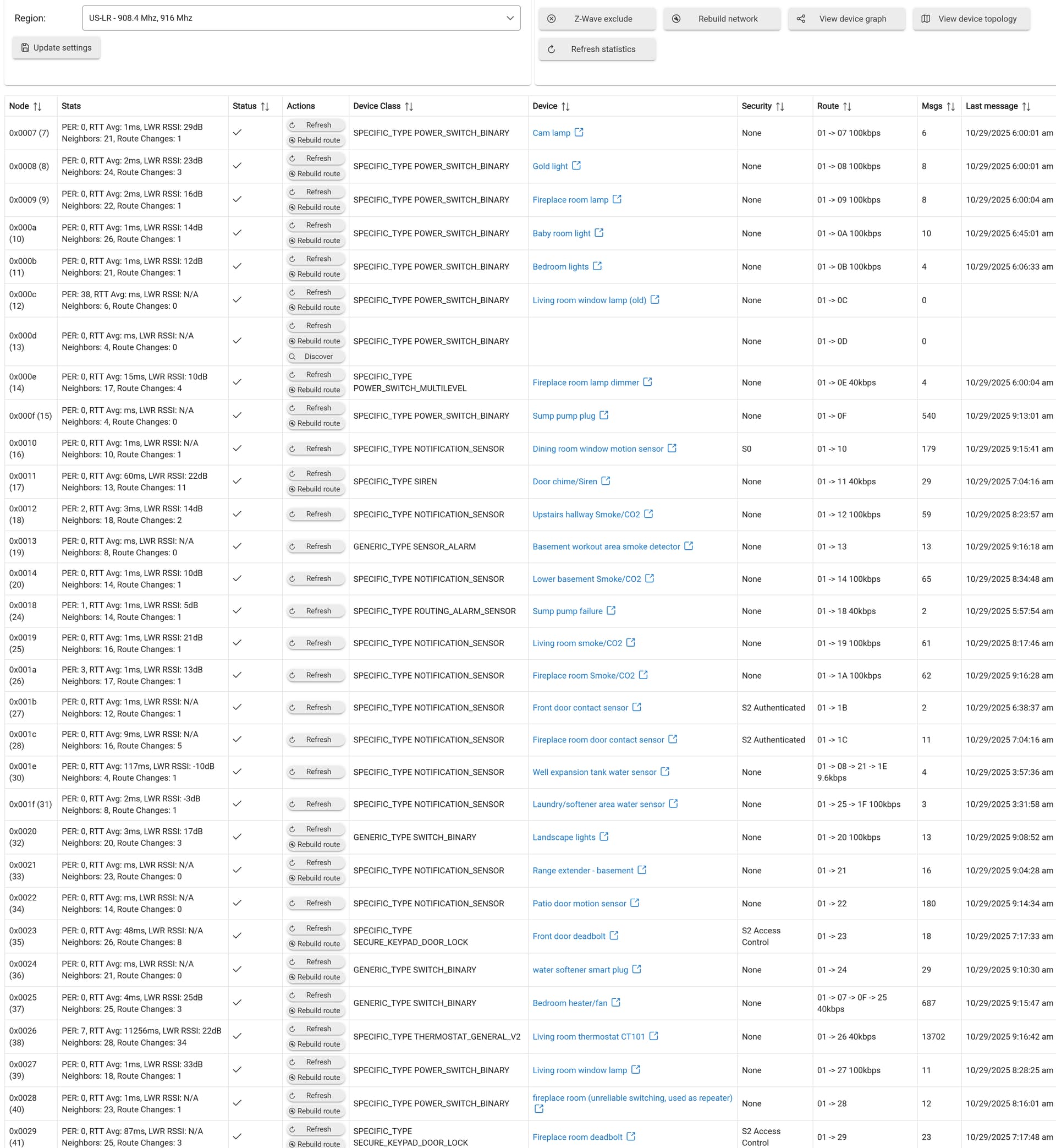

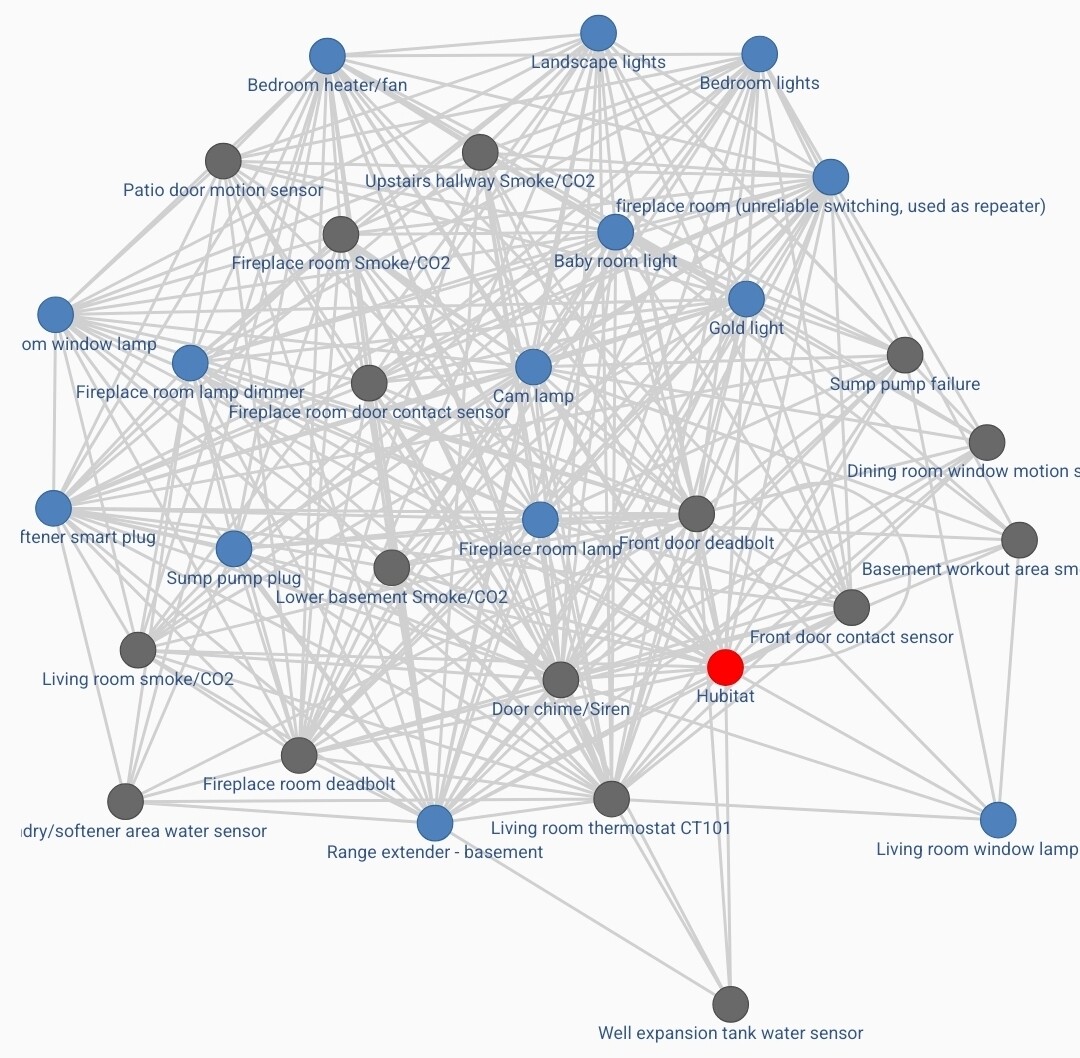

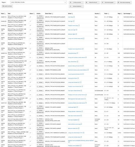

Not sure if this is relevant, but here's the zwave graph.
It can be other zwave devices that cause the mesh to weaken and the CT101 is seen as the cause. It's difficult to diagnose that condition. The rules of thumb for those zwave rebuild buttons have changed since I last had a need to understand them. I would not rebuild the entire network. Device refresh probably won't hurt. Probably won't help either. If it's slow because of re-transmitting and re-routing that would show up in the statistics of some or more devices. It could also go away on it's own.
Do you have access t a device with a larger screen?

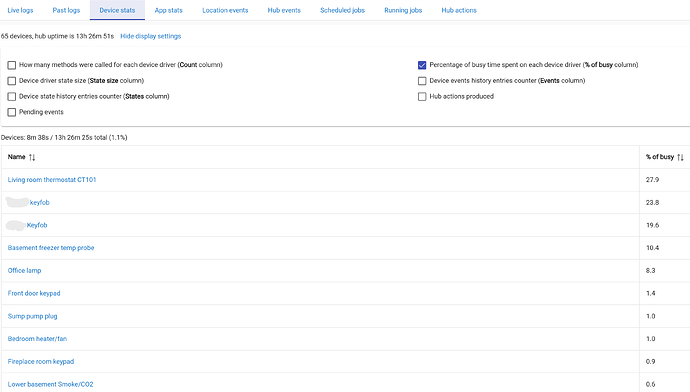

Really need to see the full zwave details, with refreshed stats (there is a refresh button up top). Should be at least 12 hours after the last hub reboot (please state how long hub has been up).
Gotcha will do. Just rebooted the hub an hour or so ago, so I'll check back tomorrow and get a bigger screenshot from my PC. I appreciate the help!
Hub uptime is about 13 hours.

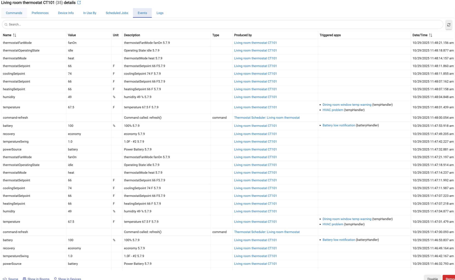

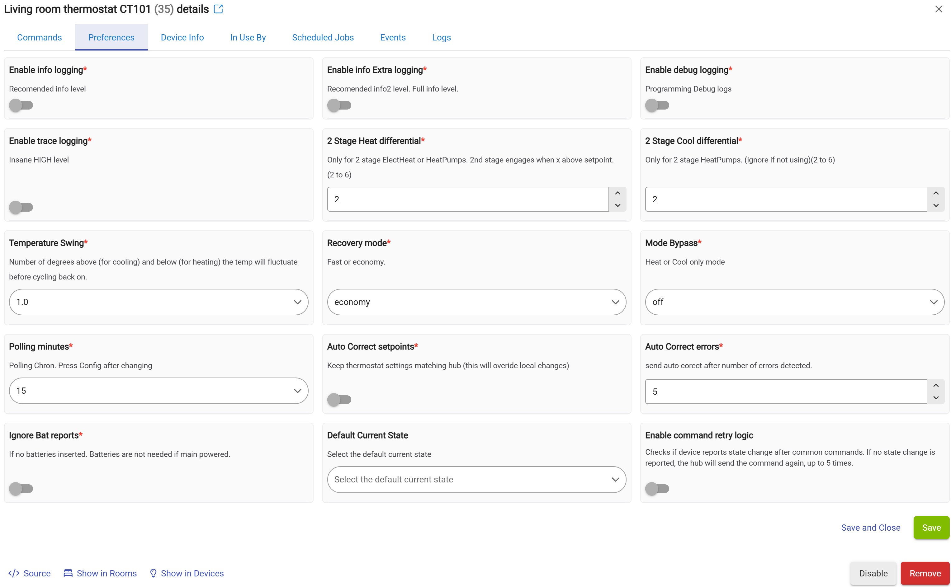

I'll click just the debug logging on the right:
This might be something, the timestamps are all super close together, but I have no idea why
And lastly here's what the thermostat is in use by if that's relevant:

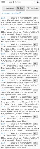

Not sure if this is indicative of anything, but after enabling debug logging, it filled up almost immediately. Here's a screenshot from just a few mins of logging.
I've tried removing the batteries and powering the thermostat down for a few mins. Checked zwave logs and its back to spamming that same "routeChanged: true," entry.

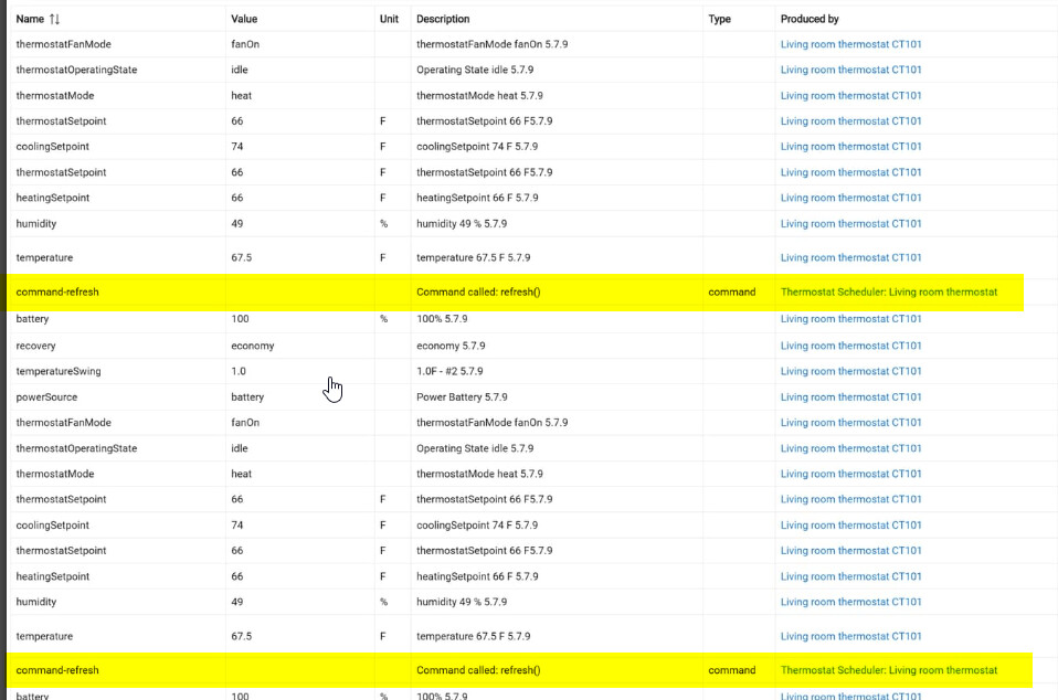

I vaguely remember there is some sort of refresh setting in the Thermostat scheduler app. However you have it setup, it is refreshing every minute.

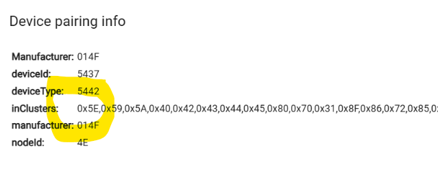

You should not need to refresh for Zwave devices at all really, unless it is an old non-plus device.
A quick way to tell is Plus devices have the 0x5E inCluster.
Tried changing it from one minute, to 10 mins and hit update/save within the thermostat scheduler app. Waited about 10 mins, rebooted the hub, and waited another 10 mins or so but it still is spamming the same thing in the zwave details logs :

Check the event log again, look for those command-refresh lines. Make sure sure they are going at the interval you set. Do you even need to refresh it?
Looks like the refresh is working at 10 min intervals in the event log. I honestly don't know if it needs to refresh it, there's no toggle to turn that setting off.
You would only need it if you change the thermostat manually on the stat itself AND the devices does not repot changes back to the hub by itself (non plus).
I would push the refresh out to 60 minutes, that will just ensure the hub stays synced up with it, in the chance it misses an event.
