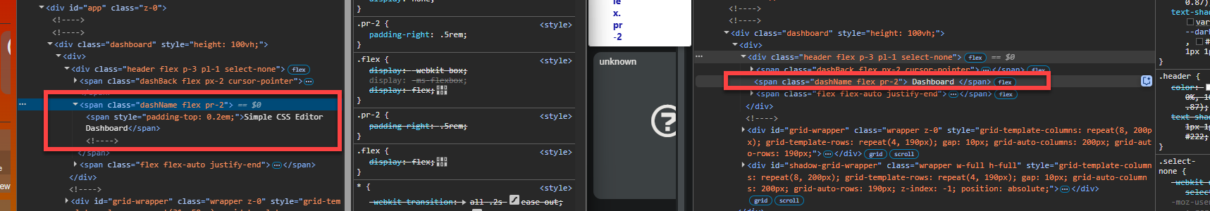

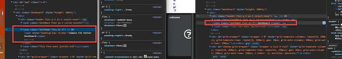

This is most likely going to be something to do with the Simple CSS Editor rather than HE itself. Let me see what I can figure out. My best guess at the moment is that the location of the dashboard name in the HTML for the page has changed slightly.
Yep, this one is on me to fix, the structure of the HTML has changed.
So no issue on Hubitat's part, it's the nature of how I went about this that I was always running the risk that this could happen. I really should change the way I handle this moving forward.
How can I fix this at this point. I rolled back the older version but would like to move forward with updates at some point. Thank You!
Ultimately it will be something I need to change in the Simple CSS Editor and release as an update to the "driver", specifically in the HTML file that is part of that package.
If you or anyone else are keen and have the skills, you can manually update the HTML file on your hub to fix the getDashName function I talk about here, but I hope to take a look over the weekend and it shouldn't be hard to fix.
