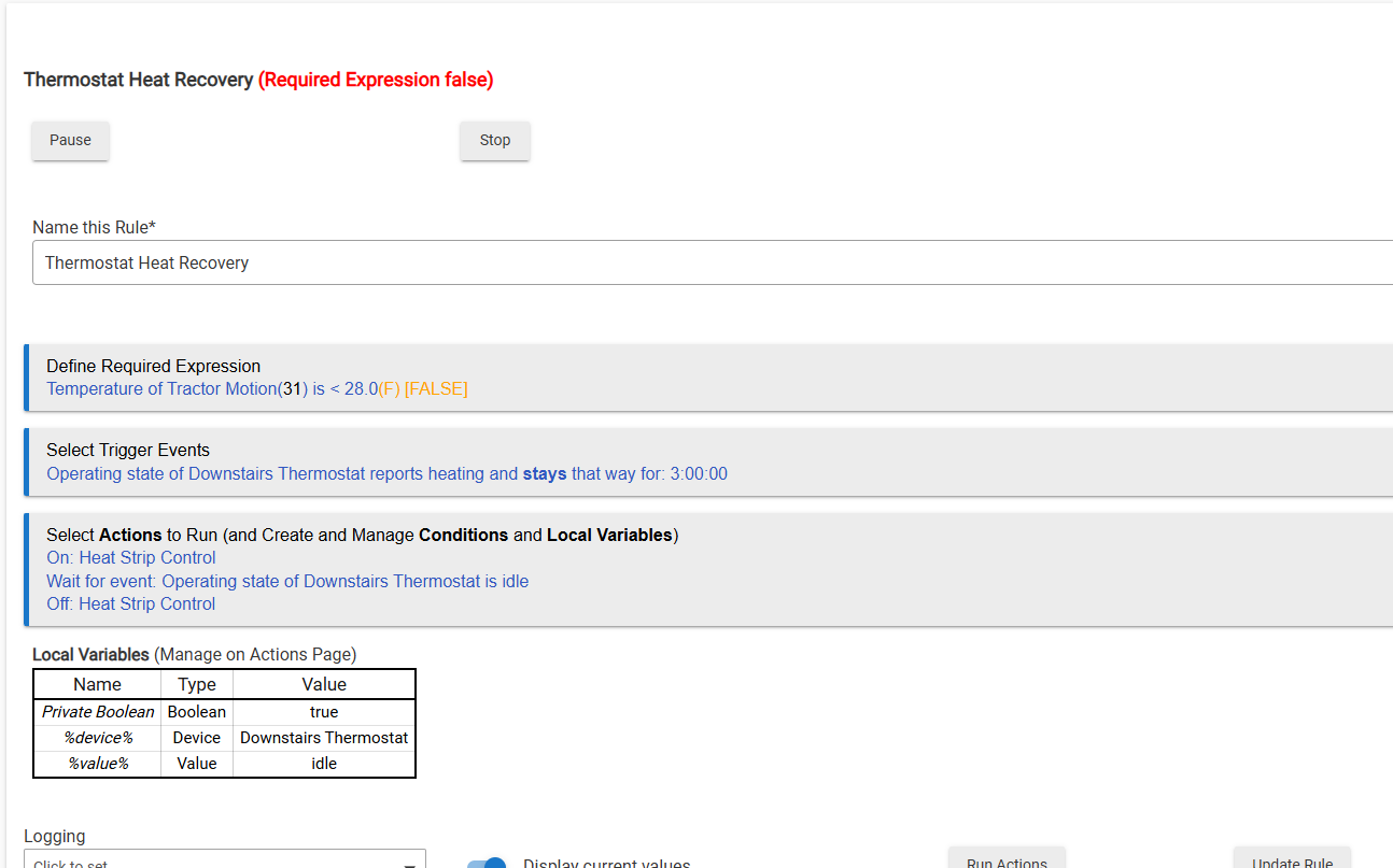

I would do this using Rule Machine. A single rule should do the trick.
Required Expression
Outside Temperature > X
Trigger
Room temp <= thermostat set temp - 1
Actions
Save current thermostat temperature to variable (OldThermostatTemp)
Set Thermostat Heat Temp to Variable: OldThermostatTemp + offset of 2
Wait for condition: room temp >= OldThermostatTemp
The Required Expression will ensure that the rule only runs when it needs to - ie when the temperature outside is coder than X.

I very much did what you are asking to do for a slightly different reason. I wanted the strips to come on when heat pump couldn't keep up, but also wanted the ability to raise the temp by 2 or more degrees at a time without triggering the strips so I set my CT101 at a 4 degree differential and then did similarly to what you suggest.
My trigger includes outside temp below like 34F, heat pump is running, and temp in the house drops. This last trigger ensures that you don't run it too soon, either.
One other thing I did that others haven't mentioned is that I had two different rules. One for turning strips on and one for turning off. I have a boolean variable that one rule turns on and the other turns off and that variable state is part of the trigger rules. This seemed cleaner than using wait conditions or things like that for edge cases.

I thought using use the built-in wait action was cleaner, but I see your point of keeping it more failsafe with two separate rules.
